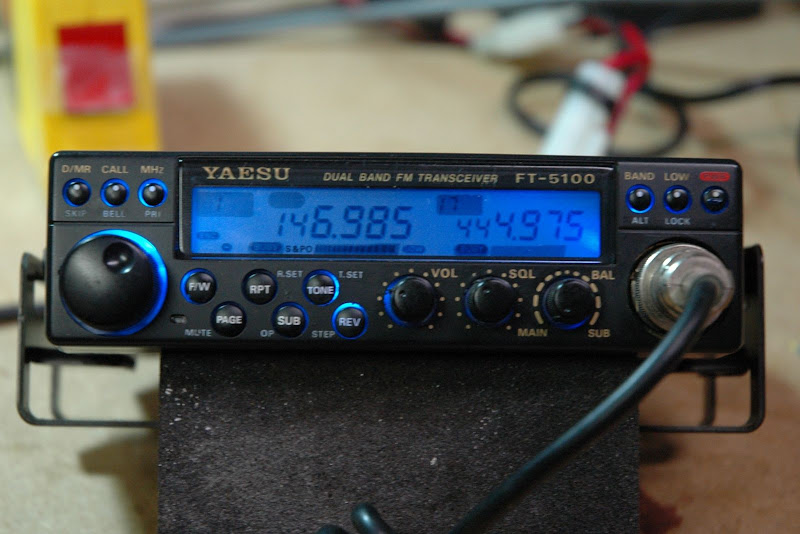

Bought this rig on the cheap at the hamfeast today. Backlights had all burned out, a relatively common occurance in this rig. Replaced with Blue LED's to give it a more modern appearance.
"Not too shabby"
Kind of hard to believe they stuffed all that stuff in a rig so small... And this thing was made in the early 90's!!!
This little dude does cross-band repeat, too...

Looks great with the cool blue LED's.
Is that all it needed?
Nice deal...

Everything else works as advertised. These rigs are famous for the little bulbs going bad... problem is, most folks don't (or didn't) know you could dim the display from the front panel. (It is NOT obvious or intuitive...) If they'd have dimmed the display one "notch", they would never have had a problem.
Another thing they're famous for is getting REALLY hot. It is because they're just barely larger than an htx-252 and do 50 watts on VHF. Little tiny heat sink with an itty bitty muffin fan. Best bet is to run it on low power!!!
And just so we're clear, I DID NOT put a swing kit in there... tee hee hee.
