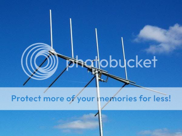

    I had a really nice conversation with the owner of Gizmotchy Antennas today. Few of you might know that they are also the makers/builders of the entire MACO antennas as well. Gizmotchy beam antennas are quite popular to this day. They are hand-made from precision jigs that are held to tight dimensional tolerances. This is also true for the MACO line. Everyone at the factory has hands on to the entire building process for all of their antennas. Including the girl who answers the phone for your questions. She is also well acquainted with any of the products, so one can ask any question and get helped out immediately.
    Gizmotchy 10/11 meter beam
    [​IMG]
    Based in Illinois, this is a family owned business that was passed down to Tom Charles in 2000. They also bought out the Wilson line of Amateur antenna products. So we will be seeing some new antennas available to the 10-15-20 meter Yagi designs in the near future as well. The Gizmotchy line presently have beams for 2 and 6 meters available. The WWRF may also be doing a review of one of these in the near future.

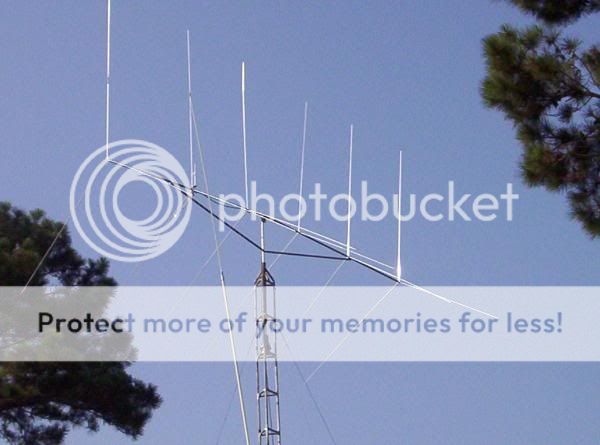

    Gizmotchy 2 meter beam...
    [​IMG]
    Since the 1960's - with refinements in materials and design

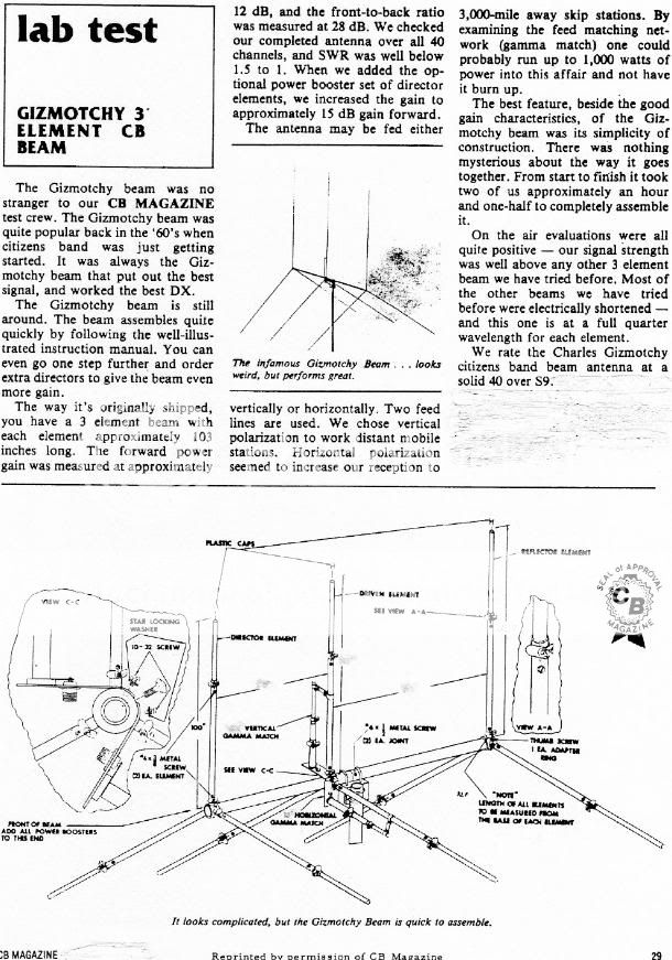

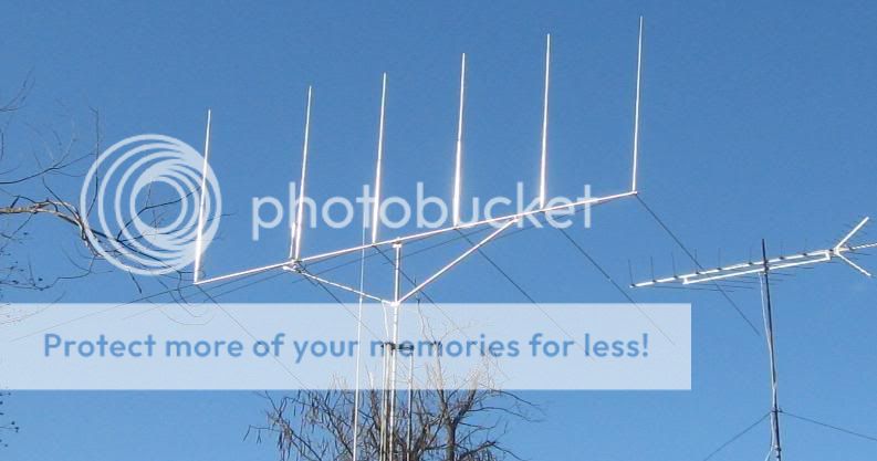

    Tom will be sending me a beam with a reflector, radiator, and director element (as shown below). As well as an additional "Power Booster" director element. The Gizmotchy beam antennas are modular in design. One can start out with a single reflector, radiator, and director - and then add on additional "Power Booster" director elements to increase forward gain and further reduce side-to-side RF transmissions. One can upgrade your own when you please - to your own needs and requirements. This modular concept is both practical and economic.

    I am at a loss here..
    How does a simple power booster as they call it..
    Actually add 4Dbd..
    it at best doubles the length..
    as such can only at best add 3 Dbi ( not even Dbd )
    Also they claim each additional adding of a power booster also adds an additional 4Dbd ( it is not doubling the size of the entire antenna every time another power booster is added )
    Seems to me ( like many antennas) Dbd or Dbi claims are exaggerated .

    3dB is 3 dB. There is no dBi or dBd when talking about EXTRA gain being added.dBi and dBd are reference points and when talking about gain increase or decrease the reference is the other gain figure quoted. Gain is gain when looking at the DIFFERENCE. It DOES matter when stating the TOTAL gain.
    I do agree however that adding one director will NOT add another 4 dB gain. Not even with another buzz word added like "ground gain" that some manufacturers like to use.

    Palco is the one that printed 4db. The article that Robb posted from Gizmotchy's site says 3db. I suspect a typo on Palco's page.

    From Palco Electronics:
    "Gizmotchy Power Booster
    Product #1006628
    Palco Price:
    $75.99 (MSRP $106.00)
    Description:
    The Charles Gizmotchy™ Power Booster consists of another set of director elements identical to those on the antenna plus an extension boom 45" long. The addition of the first Gizmotchy Power Booster adds approximately 4 db to the forward gain to the antenna. One or more Gizmotchy power boosters may be added to the antenna. The weight of each power booster is 4 lbs."
    I suppose it is how one defines 'approximate'.
    Does that mean 3.6Db's - and rounding up to 4?
    Or - was it a misquote?
    Either way, when I review it I will find something definitive.
    Since the Gizmotchy has +12Db gain before the add-on director; I should see a minimum of +15Db forward gain with the added director/"Power Booster". This added booster will change the antenna from a 3-element beam - to a 4-element beam.
    Now, every 6Db is equivalent to one S-unit. Since my other antenna is an IMAX - with +6Db gain - the difference from the two antennas should be 9Db gain or more. To put it another way, I should see a 1 1/2 S-unit gain difference (9Db's = 1 1/2 S-units) when switching from my IMAX to the Gizmotchy. I'll be using my Dosy 4002-SW as the switching platform since it can handle up to four antennas. SO - that will make the switching and comparing the antennas a breeze.
