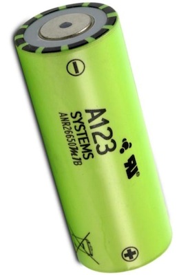

So I seen on SEVERAL RC Car forums you can make your own battery packs.
I want to make one for field use with my QRP radio.
First, here is the battery I will use, 16 of them
Nominal voltage: 3.3V
Nominal capacity: 2.5Ah
This is how I ASSume it is wired. Let me know what you guys think??????
They build Nanophosphate lithium ion batteries, this is like the latest tech in rechargeable battery's, I think they are using them in some of the new electric cars .
Jeff
I just went and looked at the Pack, only thing diff is they add a internal self-resetting polyswitch (to prevent short-circuits) and installed Anderson Powerpole connectors.
$285.00 for there product.......Just find the polyswitch and that is a big savings.
Jeff
Mouser has PolySwitches, I have no experience with those and have not figured out where in the circuit it would be installed and what size I need??????
In the + lead I would think, and choose one that is rated for say 15 volts.
How much current do you need....How much does the FT 817 draw?
The Polyswitch is placed in series with the Load

The TE AGRF1000 Operates at 16 volts The maximum voltage across the PolySwitch device under a typical fault condition. In many circuits, this is the voltage of the power source in the circuit. It may be possible to use a PolySwitch device at a higher voltage, but each such use must be individually qualified. The largest steady state current that, under specified ambient conditions ( ie room temp), can be passed through the PolySwitch device without causing the device to trip is 10 Amp.
These are typically used in automotive apps.
Product Highlights:Radial Application
Vmax Operating = 16 V
Family Name = AGRF
Radial Construction,
Through Hole Construction
IH (Room Temperature) = 10 A
