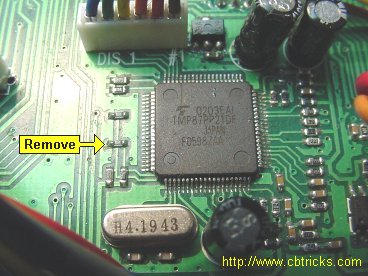

Remove Cover and locate the TMP87PP21DF microprocessor near the front of the radio.
3.
Locate and remove the surface mount resistor (R138) to the left side of the microprocessor. (As shown in the graphic above.)
