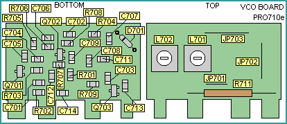

Uniden PRO710E (UT-316)
VCO PCB Layout
C701 39PF /SL R704 10K
C702 0.01UF /Y R705 39K
C703 0.01UF /Y R706 100
C704 0.01UF /Y R707 15K
C705 39PF /SL R708 330
C706 15PF /CH R709 56K
C707 47PF /SL R711 1K
C708 100PF /B
C709 330PF /B D701 1SV73EB
C711 39PF /SL
C712 68PF /SL Q701 2SC2814F5
C713 0.01UF /Y Q702 2SC2814F5
C714 0.01UF /Y Q703 2SC2814F5
R701 33K L701 LB537
R702 100 L702 LB537
R703 390
