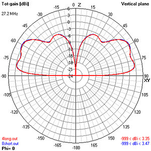

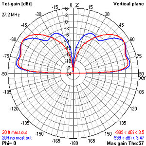

If they have the same tip height, the gain and radiation angle will be very close to each other. However, I find it strange that you would ask this question in a place where I am comparing elevated radials??? All of the antennas discussed here are elevated with elevated radials. Further, doesn't your questions deserve a thread of its own on the main forum?
