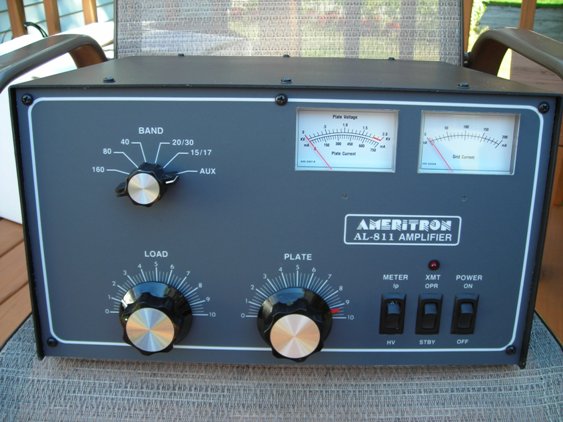

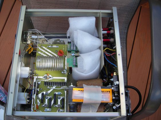

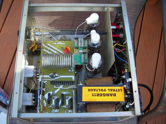

Well the Amp Supply price wasnt as cheap as I thought it was going to be. He finally said he would take $350 with no Tubes. So I have a brand new AL-811 sitting next to me.
I guess going new will be the best thing in the long run, warranty and all.
Took about an hour to get on the air with it, contacted 3 different stations. I was hearing 1 station at about a S3 to S4, tried to contact barefoot, but he wasnt hearing me, turned the amp on and made the contact with a 59 report back from him.
So I look forward to giving it a try on some pile ups ..
