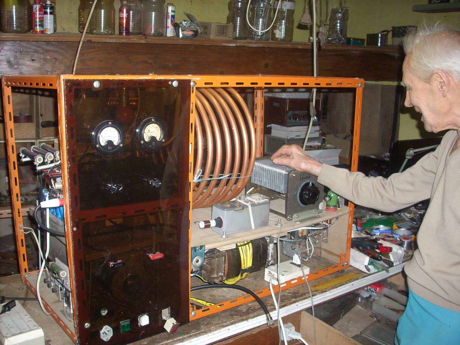

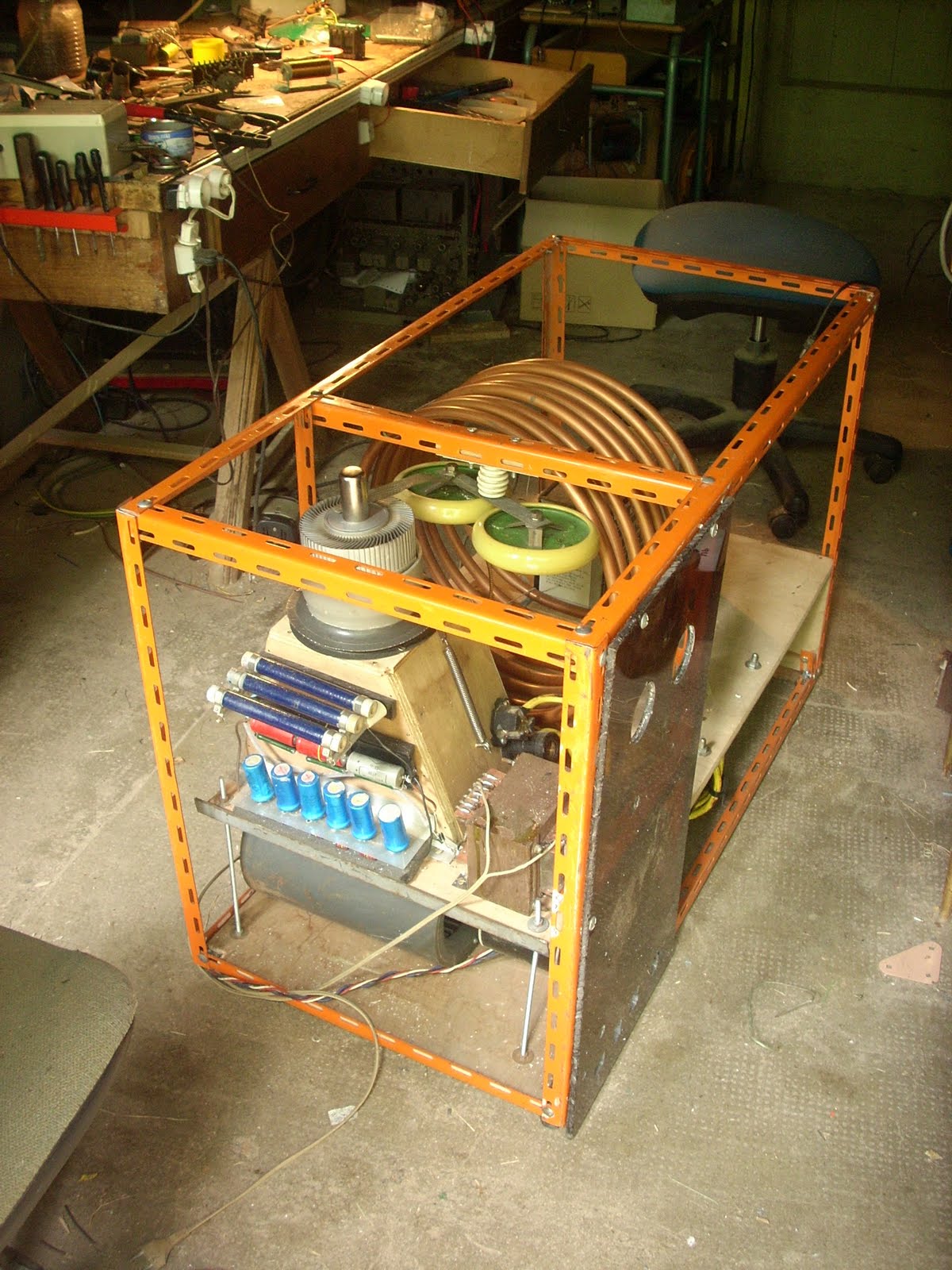

Two GU-47B by UY7MM.
Power output: 10 kW
Power supply: 380 V
Driver Power: 200 W
Holy sh#t.....that is a mean lookin skanger banger. (y)

Look at the 6.3V current requirement!!! You are not going to plug a beast like that into the wall of your home. By the time you have the plate transformer going and the fill. transformer going even with no load you would be grossly exceeding what most homes are wired for I would imagine.

90 amp at 380 sure have to be three phase.

Something is seriously wrong if it takes 90 amps on a 380 volt line to make 10 KW output? That's over 34,000 watts of input power. It's probably closer to 50 amps maximum unless the tank circuit is way off.
