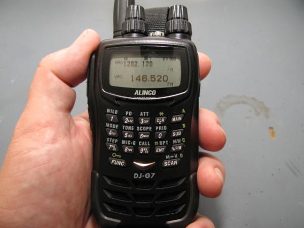

Here is a picture of the DJ-G7:
You can tell right away from this picture that the display is very crisp and easy to read, and this picture is taken without the backlight on. It is also very simple and free of clutter. There is something to be said about simplicity on the display. Some radios (like the Yaesu VX-8r) seem to try to display the status of every setting on the screen at once. My first impression of the DJ-G7 was, "Well that's refreshing; A simple display, for a change."

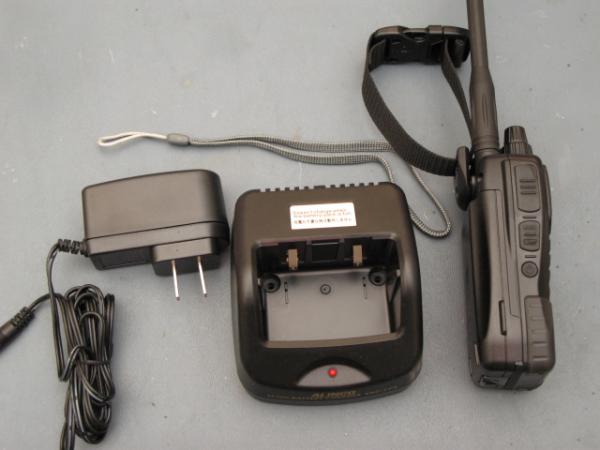

Here is a pic of the radio and all of the supplied accessories:
The U.S. version of the radio comes with a 1200mAh Lithium Ion battery, a nylon belt strap (shown attached), an A/C wall wart charger, a wrist strap, and a drop in charger. You can charge the radio by either the A/C wall wart directly or by using the drop in charger. The fact that they include the drop in charger is a testimonial to Alinco's committment to providing exceptional value with their products. Most other brands charge us extra for that accessory, but Alinco includes it! :thumbup:

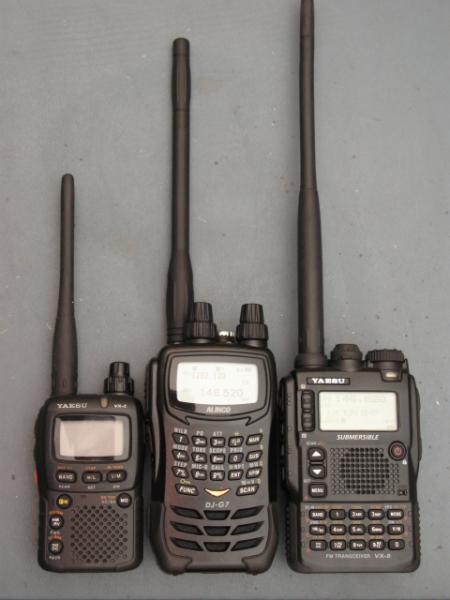

Here is a picture of the DJ-G7 next to two other familiar HT's for size comparison: the Yaesu VX-2 and VX-8r with the extended battery:
You can see that the Alinco DJ-G7 is about the same width as the Yaesu VX-8r, if not a little narrower.

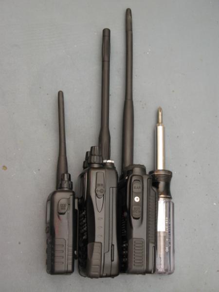

Here is a sideways shot of all three radios for size comparison:
The Alinco is a little fatter than the VX-8r with the extended battery, but not by much. Keep in mind, though that the Yaesu VX-8r with the standard 1100mAh battery will be quite a bit thinner than the Alinco. I think the Alinco has a real good, ergonomic feel in my hands. Even though it's slighly larger, I like the weight, location of the buttons, and the very large PTT button.

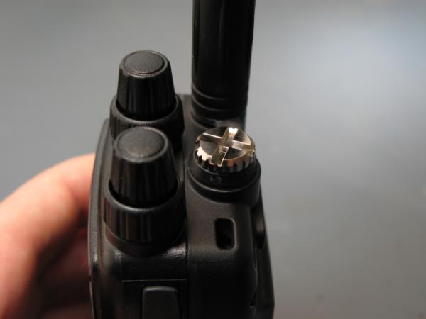

This is the top of the radio where optional speaker/mic plugs in. Notice that the speaker/mic plug is covered by a metal screw cap with a rubber seal. The rubber seal is obviously there to keep out moisture an dust. This is another interesting, unique design feature of the DJ-G7.

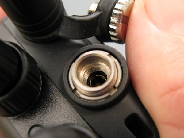

Here is what is underneath that screw cap:
The speaker/mic connection actually screws in using a metal housing. This speaker/mic connector is a little larger than one that you will find on other radios, so it's not exactly standard. Even if it was a standard size, you won't find many connectors that will be able to fit into the radio housing snugly enough due to this radio's screw-in connection. On the upside, this connection is very sturdy and rugged. One of the complaints I always had about my Kenwood TH-F6a was that the speaker/mic adapter was cheap and I had trouble maintaining good contact with the terminals. I don't see that happening with the Alinco's connector. Of course, this means that you are required to purchase Alinco's speaker/mic adapter, as well.

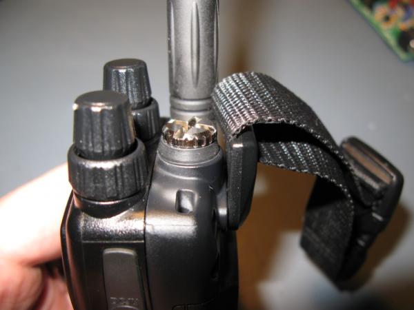

Here is a picture of the radio with the belt clip and strap attached:
This is an interesting approach to putting a belt clip on a radio. I tried it out and you can release the clip and remove the radio from your belt with one hand. However, putting it back on your belt is time consuming and requires both hands. You're better off just sticking it through a belt loop if you intend to use this accessory, but then you'll have to put up with the radio twisting around because of the width of the nylon strap.
You can see from the picture that the belt loop attachment sticks up next to the speaker/mic input. This is my biggest gripe about this attachment; it is a major chore for anyone with fingers larger than a child to unscrew the speaker/mic cover with that belt clip attached. The easiest way to do it is to just detach the antenna so you can get your fingers in there. I really hope someone comes out with a different belt attachment for this radio.
