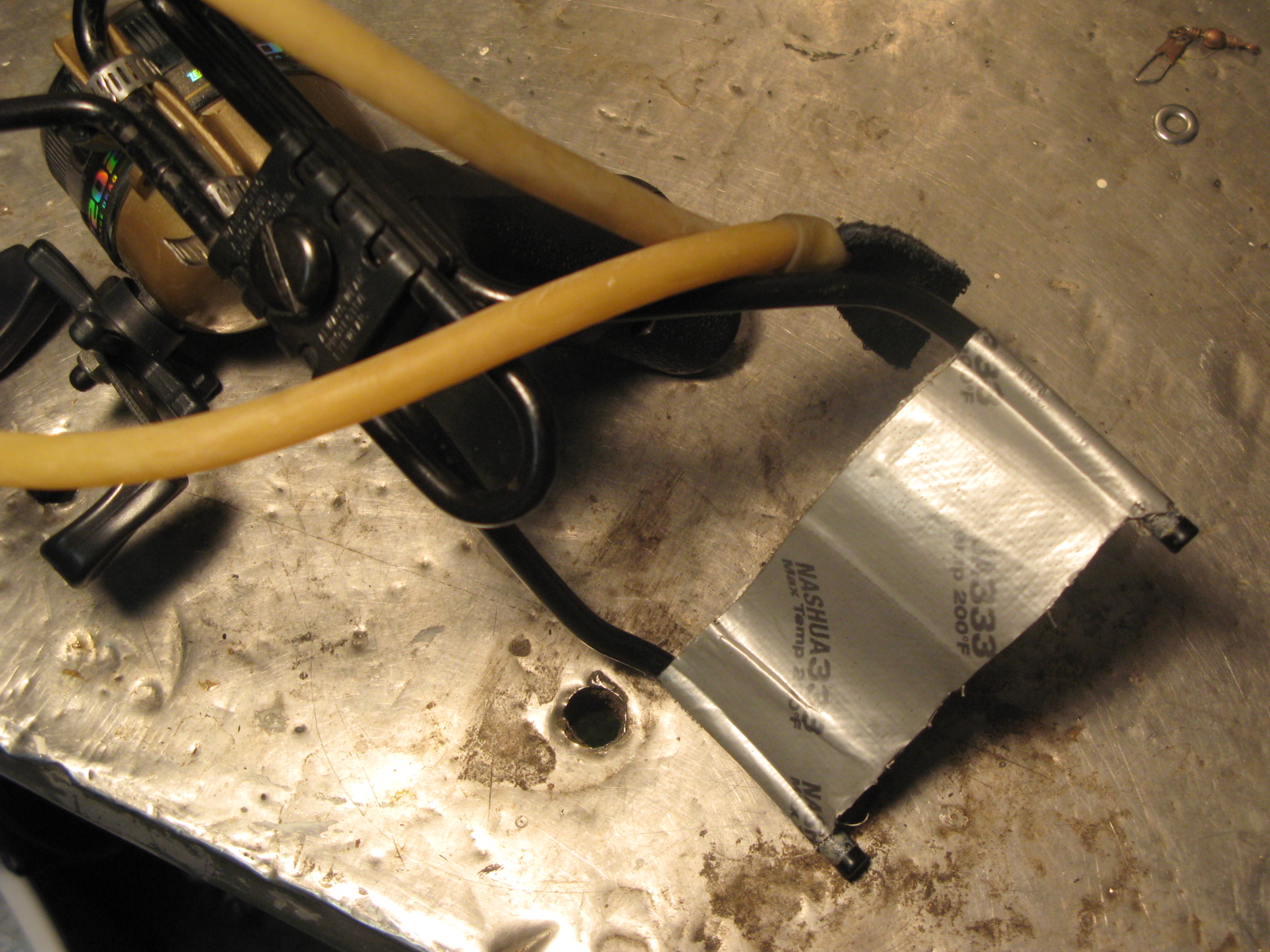

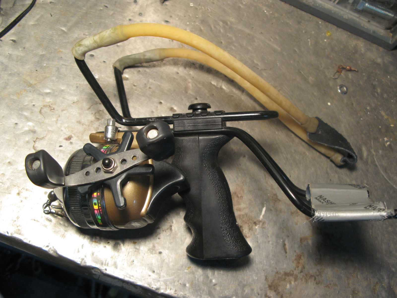

It's pretty self explanatory from the pictures below. You can use either a cheap spincast reel (pictured) or a small spinning reel. Walmart has some combo spincast/rod packs for about $10 right now. The slingshot is in the sporting goods section and was $9. Last time I checked, they're still that price. The cheap leather arm strap broke after several uses so I just made one with duct tape. That duct tape has been on there for 3 years now! You might want to buy a couple extra bands while you're there...they tend to rot after sitting around in the garage for about a year.

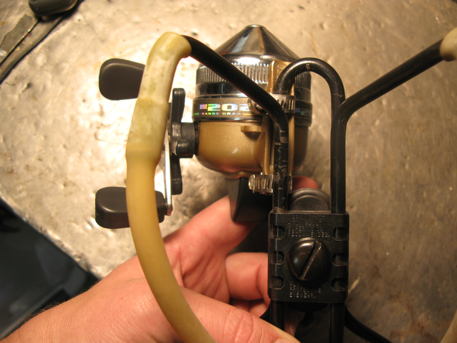

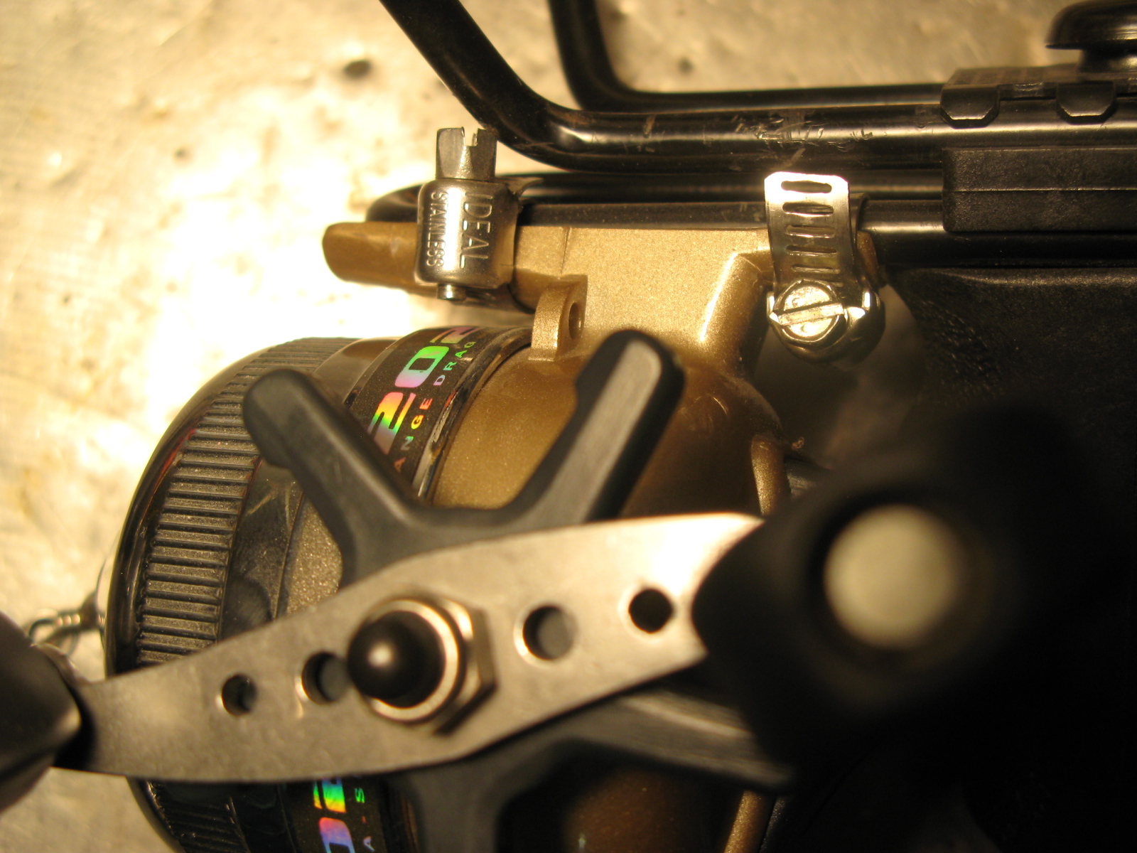

A couple of small hose clamps secures it, but you could even use heavy duty zip ties. Get a fishing swivel snap and about a 1/2 oz fishing sinker and you're ready to go. Tie the swivel snap on using a Palomar knot. If you don't know how to tie a palomar knot, here's a video from a guy with a funny accent to tell you how:

To use it, put the reel in free spool, put the sinker in the pouch, aim the slingshot and fire. It'll probably take you a few tries to get it exactly where you want it in the tree. Let the sinker drop to the ground, then take the sinker off and attach your line to the swivel snap. Reel the line up and over the the tree and back to you. You now have a line you can use to raise and lower antennas.
