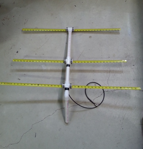

Beside the basic dipole the 2 meter antenna is one of the easiest antennas to build. Built plenty of them over the years. For better performance build a quagi. That is a yagi with a quad rear end. Google will show you all the histor so need to re-invent the wheel.
Your local welding supply store should have all the aluminum welding rods you need. they are 3/16 by 36 inch.Lowes has rest of what you need. Cheap to build. Here is a pic of one of my best performing antennas I ever built. It is a wooded boom VHF/UHF quagi long boom. VHF is not to bad but UHF you have to be dead-on your measurments.
This antenna has been up 3 years now.
attachment.php
