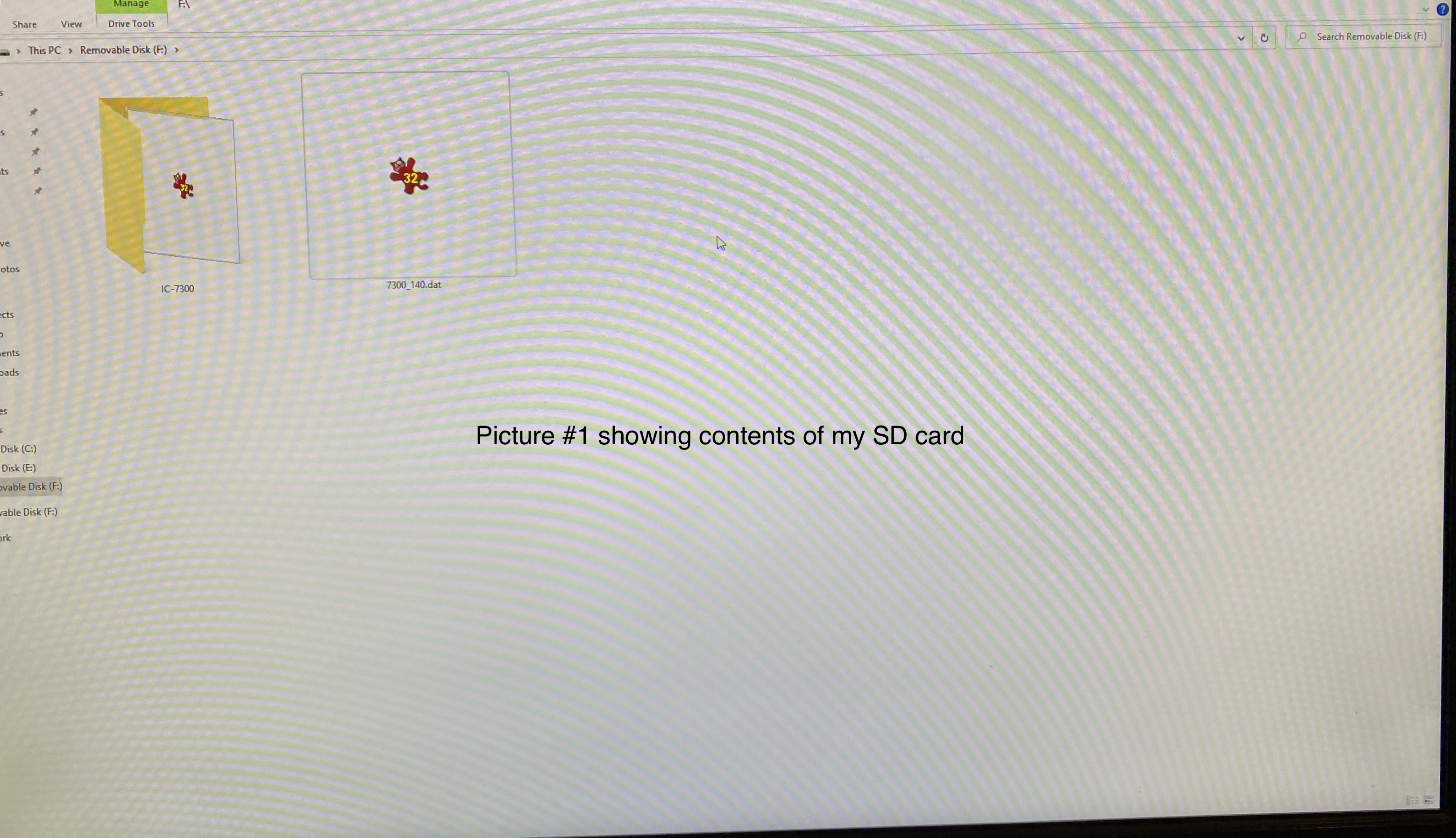

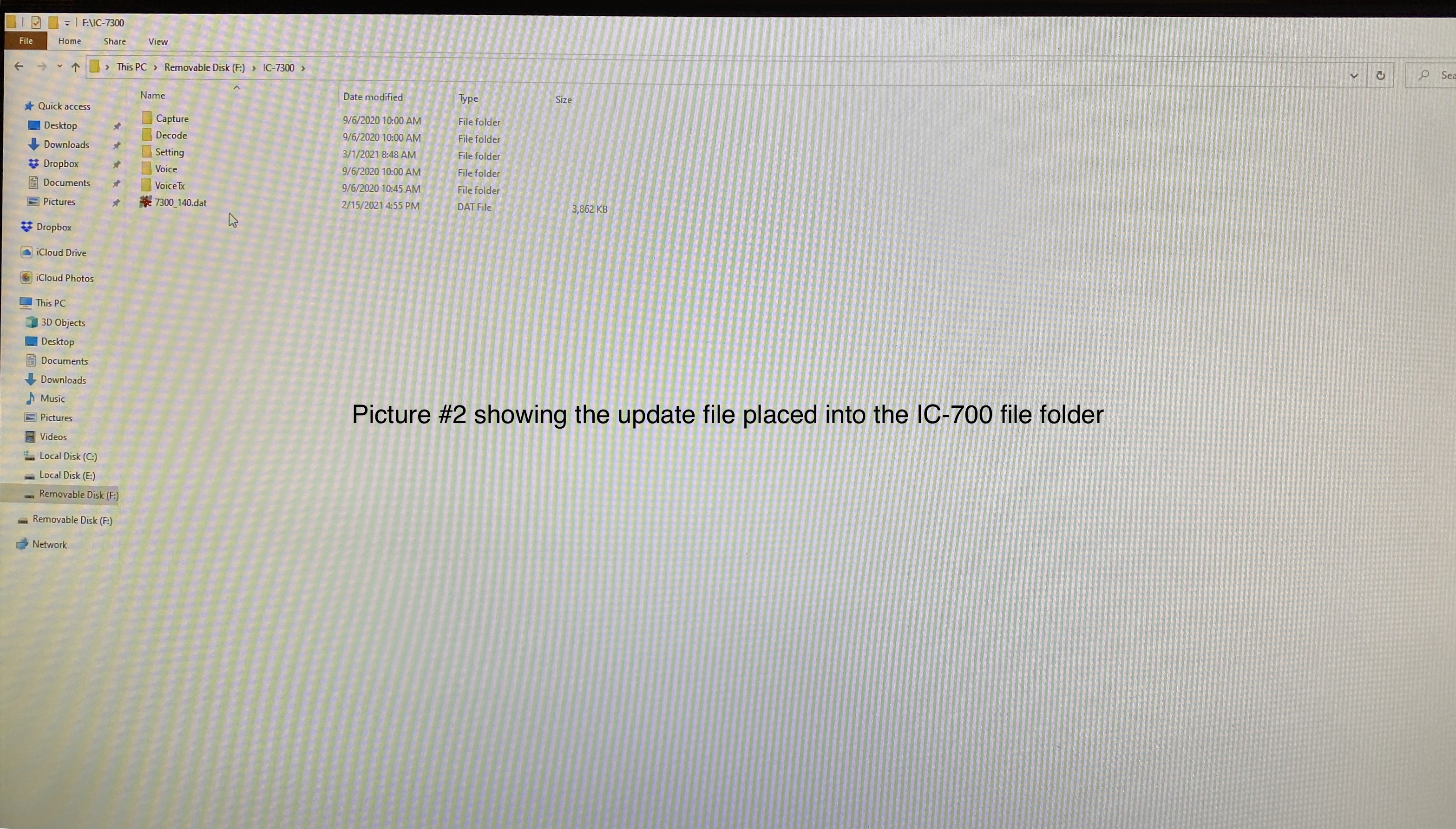

Okay here are two pictures. One shows the content of my SD card. The second picture shows that I placed the update file into the IC-7300 file folder.
