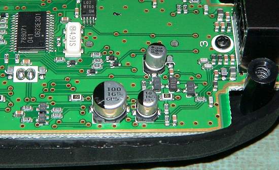

(Pix 1) Remove the original surface-mounted resistor

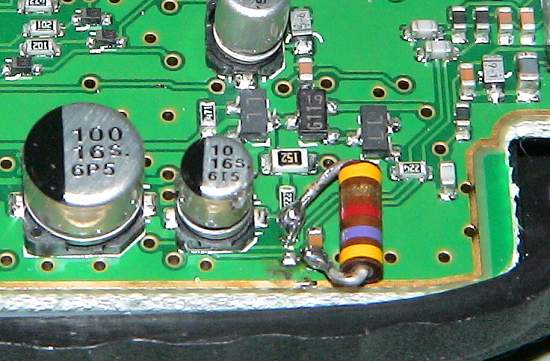

(Pix 2) Replace it with a 4.7 K resistor
This modification will result in a pleasing increase in sensitivity of the microphone. The new ratio of the replacement resistor will provide an increase of the mic element's audio level.

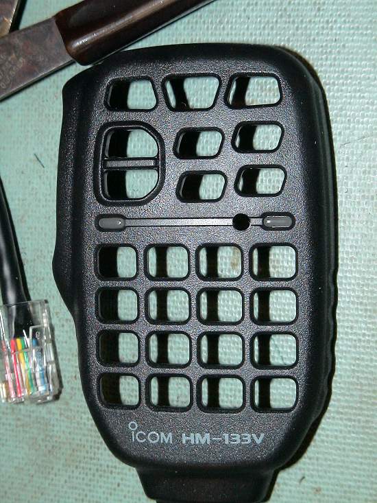

(Pix 1) Drill out (enlarge) the hole as shown

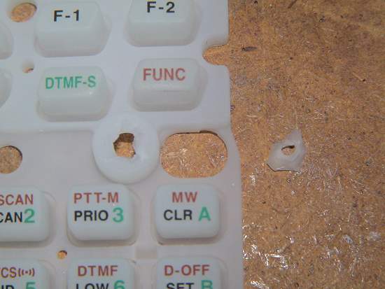

(Pix 2) Remove the poppel-pad, and remove some of the restriction material. (This pix shows the removal of the soft rubber in-progress)
