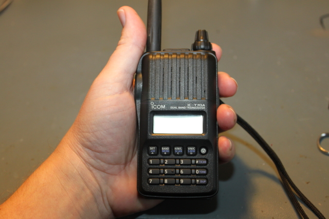

Here are a few pics that show the size and dimensions of the radio:
Front:

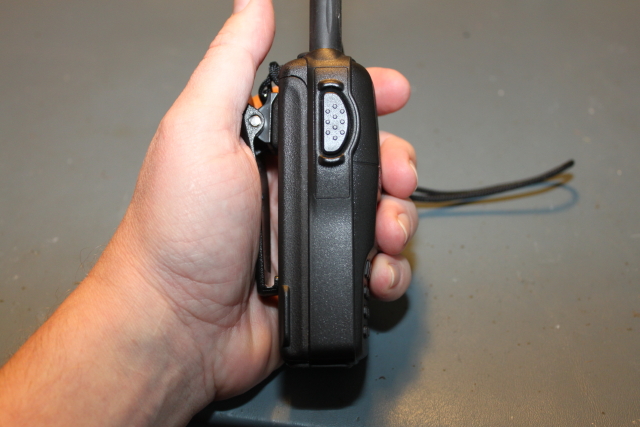

Side:

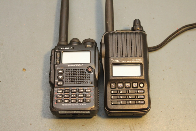

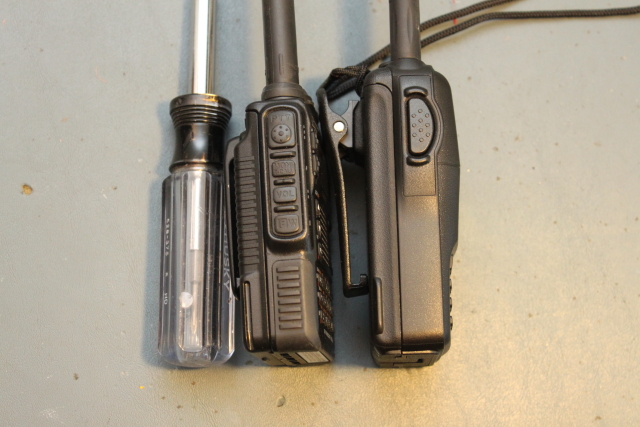

Here is the radio next to a Yaesu VX-8r for size comparison:
Width of both radios shown. Note, the VX-8r has the extended battery installed:

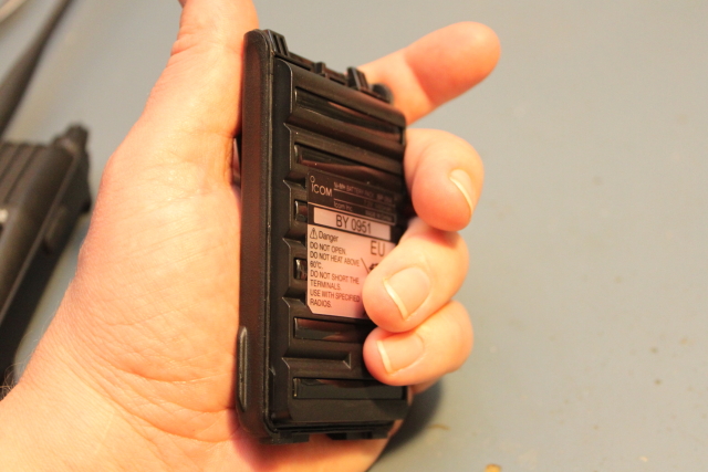

Note the large battery:
The battery power in this radio seems to last forever. As a test, I gave the radio a full charge, and then decided to see how long it would last just monitoring before dieing. It has been monitoring my local police dispatch for 36 hours and it has not died yet. Keep in mind, that I have not used the radio during this period to transmit, and I've kept the volume at a comfortable listening level. I intend to keep it on, doing the same thing to see how long it will last. Whatever Icom is doing to conserve battery power while receiving is working well.

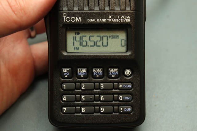

Here is a close-up picture of the display and keypad of the radio:
The first test I always do with any new HT is attempt to figure out the basic, necessary radio functions without reading the manual. I try to figure out how to change bands, activate duplex/tone/repeater settings, and switch between VFO and Memory mode. I also usually try to enter the Set menu and see how many options I can figure out. I do this as a barometer of how easy the radio is to use. I can honestly say that the basics of this radio are incredibly easy to figure out, especially if you've used any HT prior to this one. I also figured out about half of the Set menu functions before looking at the manual.

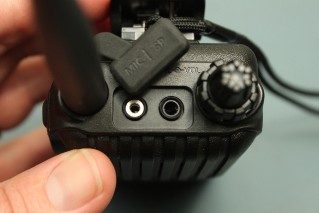

You can see from this picture that the radio uses standard mic and speaker jacks, which is always good if you like wiring your own connections to save a few bucks:

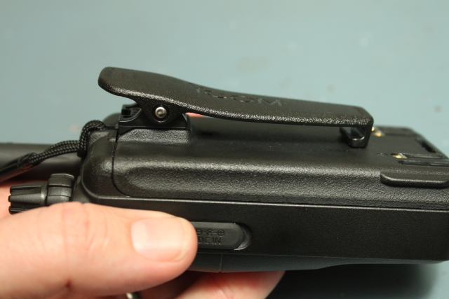

And lastly, here is a pic of the supplied belt clip which snaps onto the battery:
It is strong and substantive, and you won't find it slipping off of your belt.
