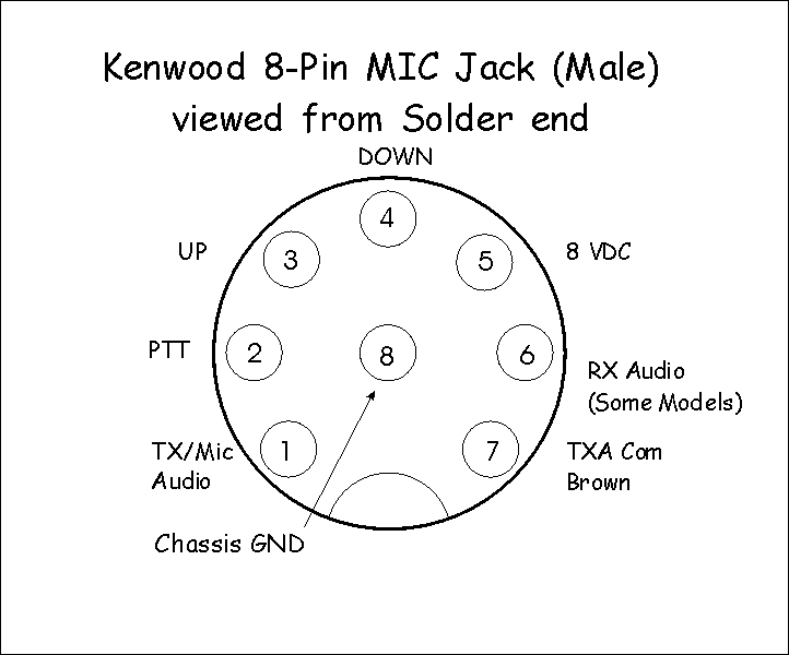

I looked on e-bay and the only microphones for that radio didn't have DTMF. Does anyone have any links to a mic that does have DTMF and is compatable with the 8-pin connector?
