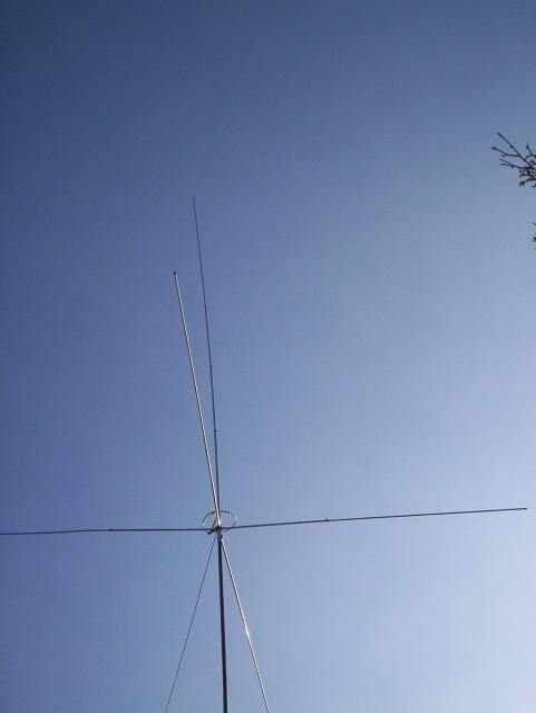

So I am very pleased with the performance of this new antenna and pleased how well the assembly went. I was given Tom Charles' phone # and was told that when you call Maco he personally usually answers the phone. I'll try to get a pic tomorrow of the antenna.
