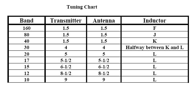

The 'original' instructions were basically the right way to do it, adjust the inductor for the loudest noise, then the two capacitors for 'loudness' too (on the 'S' meter). That gives you a 'ball-park' starting point. Then at low power, adjust for maximum output on a watt meter, or lowest reading on an SWR meter. It will become easier the more you become familiar with things. The settings given in the manual are only very 'approximate', what you might see if you've got an antenna system that's fairly 'close' to right to start with, and shouldn't be thought of as the settings you will end up with. They make a fair starting point though.

The more you 'fiddle' with it the more accustomed you get to twiddling knobs, and seeing what happens. A very good idea is to keep notes of the various settings that result in a 'good' results! There are various ways of keeping those notes, use the one easiest for you. [How about marking the tuner's settings on it's face, or in a list, or cutting a slot in an index card that'll fit over a knob's shaft and slide that card behind the knob, lots of ways. The numbers around the dials don't relate to any particular values, they are 'logging' scales. It's a pretty good idea to take the 'lid' off and see where the minimum/maximums are for each capacitor and inductor, which end of that scale is the most and least. One reason for that is that you want to use the least amount of inductance/coil as is required.
