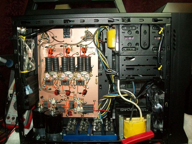

Mack, having seen some of your work I respect your opinion on quality and craftsmanship. This was posted by Black-Hole on sparky's forum. What do you think?

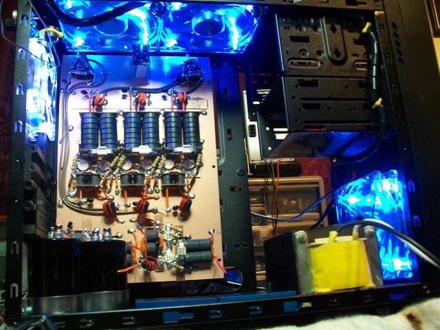

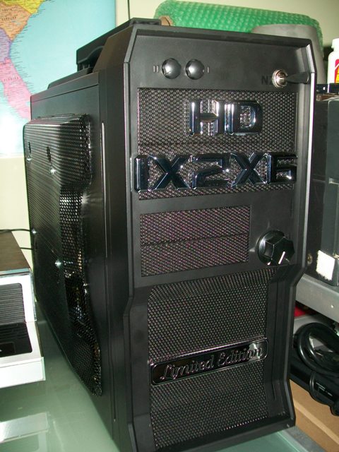

Nice use of a pc tower, let me know when he gets it tuned, it has no output tuning in the picture.
And it would be nice if guys would learn how to cut their pill strips so their trannys line up like the pros.

Looks like a nice clean build.

What in that picture makes you think it is a nice clean build? the fancy blue lights? for one, it looks like poop wire lengths all different as Mack said the transformers look like a blind man installed them, besides a host of other bad rf practices.
Appears to me that someone else built that "amp" and he simply took it apart and reinstalled it in a pc case.

Might as well chunk the balancing resistors on the output combiner in the trash, they are going to smoke anyway. 1 sd 1446 driving 2x1446 driving 6 2879's, nothing clean about that. Some people should stick to making bird houses for a hobby.

That pretty much describes most amps built solely for 11m. :whistle:
