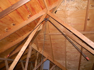

Will probably just hang a wire dipole. Had one up there as an Inverted V once but, truth is, it didn't perform any better than my 4' Firestik dipole seen here:
I think that's because the Firestik version was more in the clear whereas the longer legs of the full-sized version were in closer proximity to a lot of things (ducting, wiring and an AC/Heating unit) that aren't visible in the photo.
If I hang a full-sized wire dipole horizontally, I can get it up in the clear better. I don't have enough room to hang it straight so it will have to be in the shape of a flat V. Or L, depending on how you look at it.
Or, I could go with a double bazooka as BJ radionut has suggested in another thread.

It looks like you should have enough room in that attic for both a 6 and 11 meter antenna. Several ways of going about that, probably the easiest or most common way would be to string up a fan dipole. Nothing fancy, just string them up as straight as you can. The ends of one dipole as far from the ends of the other one as is practical. Or just make a big 'X' out of it. And naturally, tune both of them (that's the hardest part, the tuning... up/down/up/down sort of).
