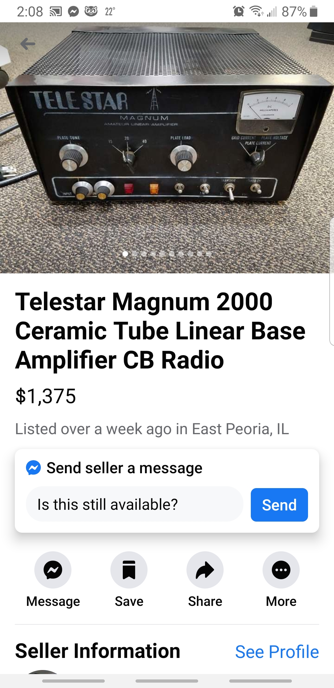

Here is one that lead me to this post as I have never heard of them and I have seen alot of amps over the years
