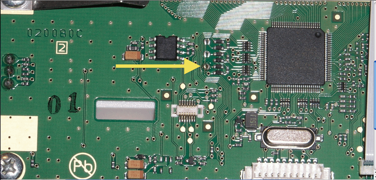

    [​IMG]
    Look inside of the front cover for 3 pads (see picture)
    Two of them are not solder jumpered and one is.
    [​IMG]
    De-solder the only pad that is jumped with a solder bead.
    [​IMG]

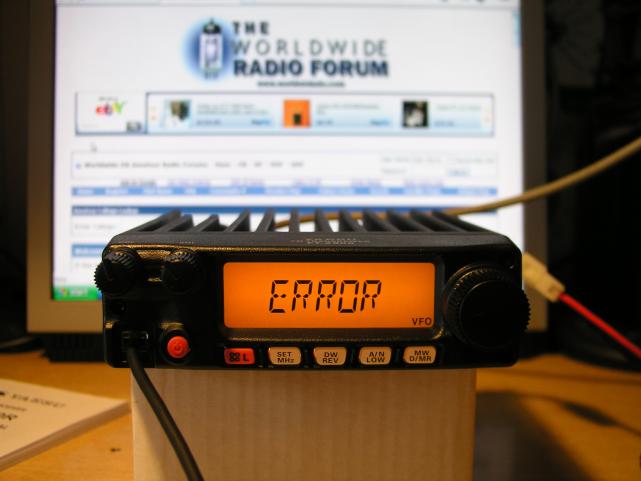

    (y) I won't say what was going through my mind when I saw Bill with a new radio he was going to mod and the next picture showed the radio with "ERROR" on the screen. :laugh:

    Thanks for posting this. I did the mod, and it was VERY simple. The pictures you posted made it a breeze to find the solder pad. Did the mod, powered up the radio, did the reset, and radio works perfectly. Thanks a bunch.
