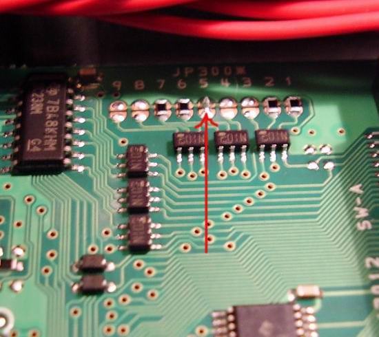

  1. Write down all your settings because they will all be lost after 'CPU Reset'
  2. Turn the radio over and take off the back cover. Locate the control board (Right front corner) you will see 9 jumpers, marker 1 through 9. add a Solder bridge to pad number 5 . See the attached picture for details
  3. Reassemble the radio.
  4. Do a Full Reset by holding the "FAST" and "LOCK" buttons in while pushing the "POWER" switch to ON.
The TX range is now 1.8-30Mhz and 50-54Mhz.
