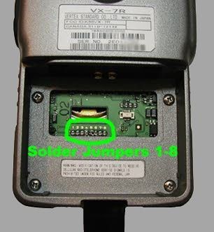

1.Remove battery
2.Remove black sticker (right above cellular warnings)
3.For Mars/Cap, remove solder jumper 5
4.for Freeband, remove solder jumper 4
5.Put sticker/battery back on.
6.Press [4] + [Band] + [V/M] keys while turning radio on.
Press F key to reset radio. Done. *You will loose any stored memory channels and other personal settings when VX-7R is reset.
Mars/Cap & Freeband TX frequencies for VX-7R:
Freeband TX: 40.000Mhz -224.995Mhz & 300Mhz -579.995Mhz
Mars/Cap TX: 50Mhz -54Mhz 140Mhz -174Mhz & 222Mhz -225Mhz & 420Mhz -470Mhz.
