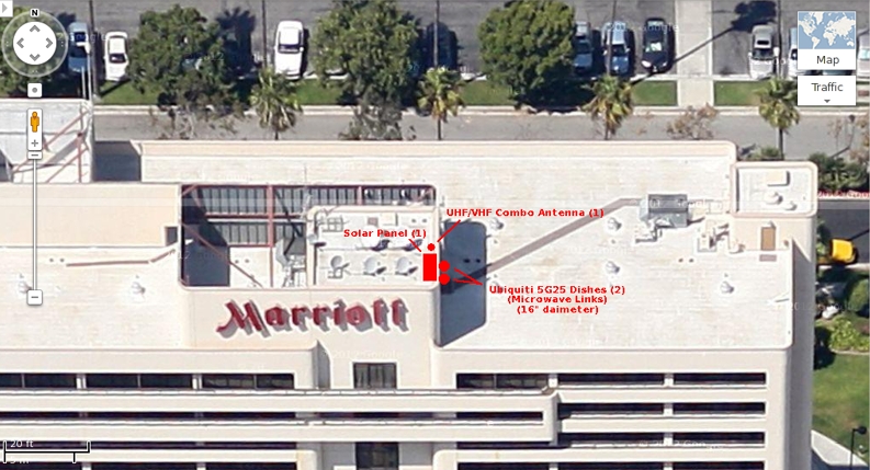

I don't want to confuse the GM with a bunch of technological mumbo-jumbo, so I'll probably just submit a simple diagram if she responds favorably ... like this:
In addition to 2 Ubiquiti dishes (back-to-back relay configuration), probably a dual-band (Puxing) 2M/440 HT with a gain antenna and some AGM or LiPo batteries to start off with. I'll install all the guts in a NEMA-3 enclosure and mount it under the solar panel. The roof-top location I'd like to utilize is actually closer to 20 stories tall (y)
The plan is to install one dish at my house, two on the roof of the hotel and one at my shop. This will allow for an internet connection, a path for my security system and DVR, and maybe even VOIP phone at the shop. The HT? ... well I'll let you guess what that's for :tongue:

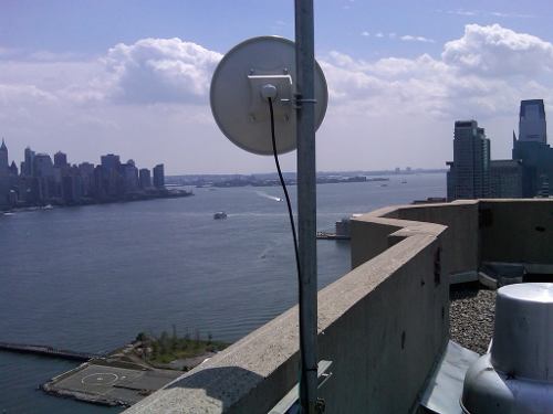

Nice view, eh? (not my proposed location)
