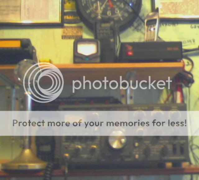

Hmmmmm....not sure how I missed this thread until now. Treat that 820S with lots of TLC and it will return the favour. I have the TS-820S,matching external VFO-820, SP-820 speaker with built in filters, and the AT-230 antenna tuner as well as the MC-50 desk mic.The station looks nice sitting on the desk and I constantly get reports of great audio_One thing to be carefull of is the shaft couplers on the bandswitch etc. They would crack over time and cause part of the switch to rotate while another part would not.That is a great way to fry something when TX'ing and may be a reason why the RX is not up to par. Here is my station.
What IS that object sitting just to the right of the ARRL Log Book? I know what it LOOKS like....
You mean that old Nye Speedex H15.682 thing with the navy knob that is mounted on the piece of stained maple with the middle hollowed out and filled with lead sheet so it will stay put? I have no idea what it is.:D Actually it's my carrier generator. I use it when tuning the finals and the antenna tuner. :love:
