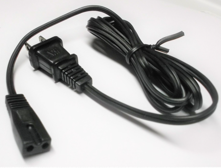

I'm looking for one to buy but I need the name of the plug.
It fits cb radio base stations and such.

well i got 3 cb radios that use that end and a few appliences that also use that end so it should be very easy to get
search terms: 13.8vdc 2 pin cybernet power cable

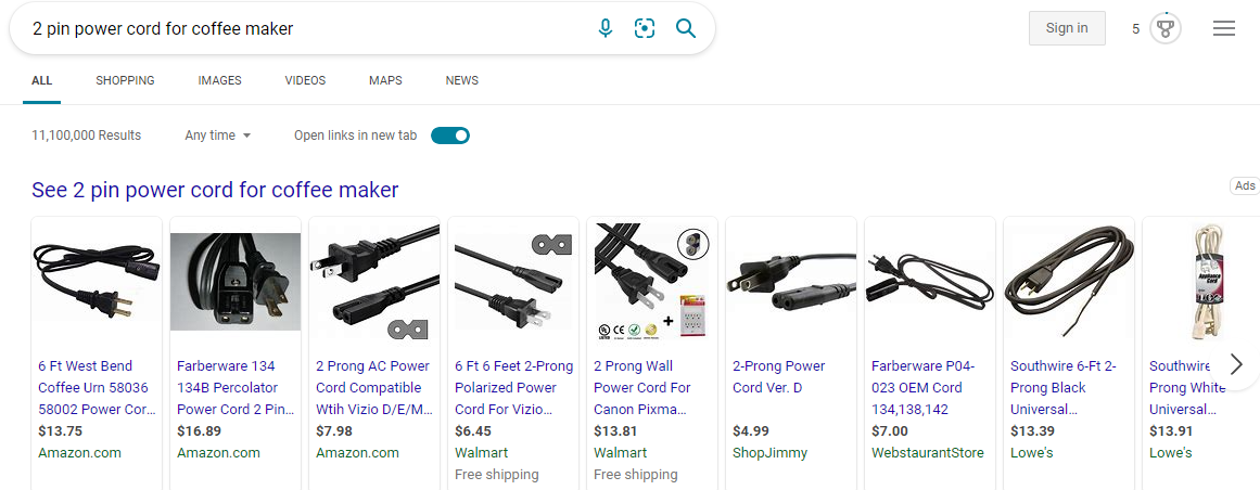

So perhaps the best way to search is to use 2-pin cord for Coffeemaker
Without an appliance - You get this...
From Walmart but is specific to MAKER of the cord...
Try this search instead ...
You get a whole slew of them...
Because of the appliance it's used by.​

Walmart has several variants and they fit the different appliances.

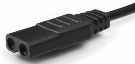

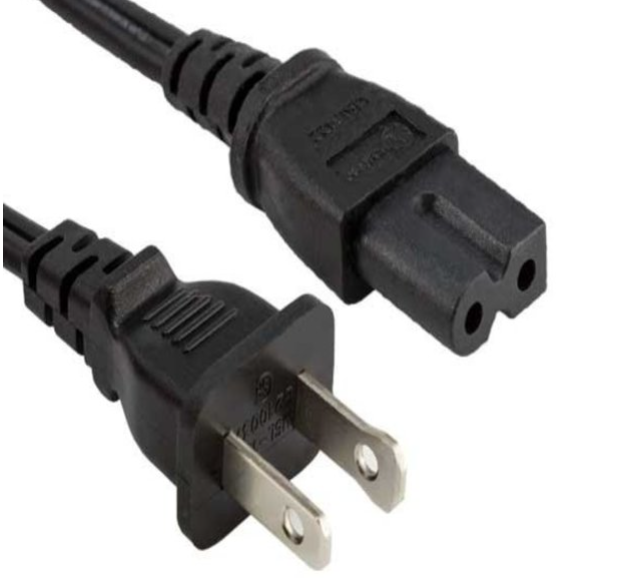

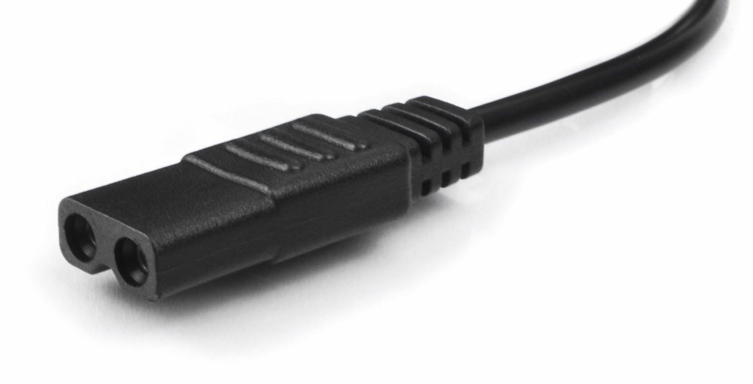

That number produces a return at Newark/Element 14. Says they are out of them. But it shows the "IEC320-7" number on that page.
Just one problem. A glance at the cord they do have on hand, the 23-196 is clearly not the same. Looks as if it would not fit the socket meant for the one with four square corners. The IEC connector is just larger.
But that IEC number is on the 23-040 page.
