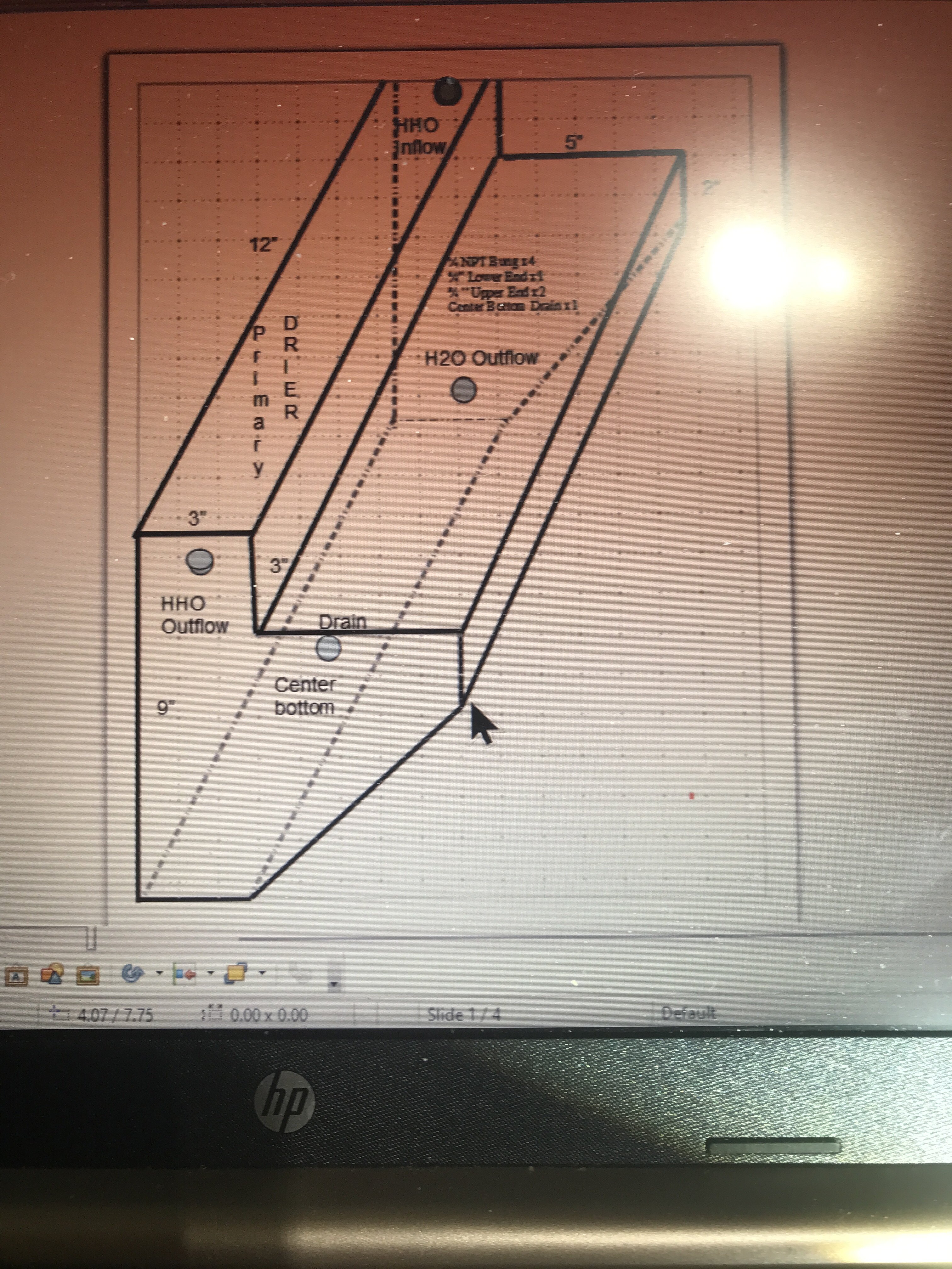

Have designed a 1.99gal reservoir with integral 1.77L Primary Drier. sorta resembles Wests Texas on the end view.
316SS 16ga 12" long with body shape like West Texas for fender well fitment. The Texas Panhandle/Srn New Mexico State Line shelf, extends another 500miles westward, for mounting Constant Current PWM, This CCPWM will allow crankin 'er up to 30A to start, 36A top target.
Original dual 1.5L plastic reservoirs buckled under the vacuum of the V8. My '70 CST also with a 350CID V8, had zero OEM ECM; and this resulted in a crap load of foam with a current increase to 17A. Had to put a choke on the vacuum and dial back the amps. Have been investigating anti-foaming agents that wouldn't have to be replenished with every fuel (water) fill-up. KOH, Potassium Hydroxide, only need be included as the electrolyzer initially. KOH doesn't get used up in the process.
Calculated 1.99g reduced to 0.9 gallon (50%) would increase the 10% KOH ratio to 22% :eek: This would normally, without a CCPWM, result in a amperage run-away. With the CCPWM the HHO production will still increase but not at the rate of an uncontrolled amperage draw.

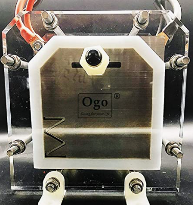

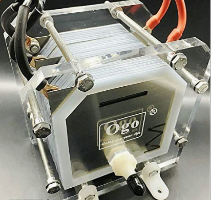

Inflow Port Outflow Port
I'm not promoting this Name Brand. But, showing an example of a 24 cell HHO generator and its likeness to one of my 3ea x 24 cell stacks.
I calculate one of these units supplied with 10A will produce ample HHO for a 2.1L - 2.7L engine
1.4L / Minute is the desired HHO production for a 5.7L (350CID V8) engine. Based on the table above at 10A I can project 1.9L HHO available to the Chevy 350 V8. At 7.5A x 3, the 3ea x 24 cell stacks would meet that 1.4L / minute HHO production. I'm jucing it at 10A (30A total) aiming for a high % MPG gain.
