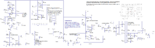

Here is the schematic I made for the Royce 1-621 PLL unit. I hope it helps someone.
Also attached is a PDF I found online for the 1-632 that contains a schematic for that PLL unit of that radio.
If anyone knows definitively whether or not the 641 PLL unit is the same as the 632 PLL unit, I would sure like to know. Thanks!

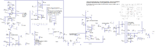

Reposting PLL schematic. First one had a couple text errors because I wrote down 39.160MHz instead of 36.190MHz. I only noticed when going to buy a replacement 36.190MHz crystal. There was also a trace connecting the base of Q10 directly to + rail from when I was trying to reroute stuff.

This one uses the M58473P as well. I forgot to add that to the schematic.
THERES A PLL UNIT DESIGN FLAW....
I just had a breakthrough with the PLL I have been working on. First, I found that the 36.190MHz crystal was bad, wouldn't even rattle my test oscillator, so after ordering a new one from Kens (and that crystal did test good) and installing it, the 36MHz oscillator was still not working. So I took that transistor out and tested it. It tested good, but the Hfe was 49. That math just dont work with those resistor values. There was barely any voltage drop across the 1k resistor feeding the collector, so nowhere near a mA... So, I decided to temporarily hold a 220k resistor across (in parallel with) the 270k bias resistor already present, and for that brief moment, the receive came alive!!! I am not sure why they used such a large value of bias resistor having such a low Hfe transistor in there. Not suer how it even worked before.
With that mystery whooped, I couldn't be happier calling it a night. That bias resistor can be switched out tomorrow (later today). Another Royce back on the air!!!!

Well done on the schematic. Although, I think it still needs revision. I specifically eye the electrolytics. You list 2, c46 & c47. c47 is listed as 120 nf. Never seen one of those before.
The 641 PLL has 4 electrolytics. So unless you missed a couple in the 621, I don't think they are the same.
Thanks! C47 and C120 are tantalum and C51 and C46 are aluminum electrolytics. Two tantalum caps were in parallel at C120 ~ one on the back of the board making a total of three tantalums used). That makes a total of 4 "electrolytic caps" on the PLL I worked on. Did yours with 4 (assuming aluminum) electrolytics also have a couple teardrop tantalum caps or were they all aluminum electrolytics?

I thought I missed a trace because I didn't see D80, but I now see I mislabeled D80 as D85 (doubling up on the use of #85, just a typo) , and thats right next to C51 which I accidentally used the wrong capacitor symbol for. I wil fix it.

The 678 sounds like the issue I had with that 621. The 36MHz oscillator went dead, and that threw the PLL out of lock and drove the VCO to its limit (around 38.6MHz if I remember correctly), and with the PLL out of lock, the 10.695 oscillator is dead, so instead of a 37MHz-10MHz=27MHz output, I ended up having 38.6MHz coming out of it. Getting the 36MHz oscillator running fixed that.
