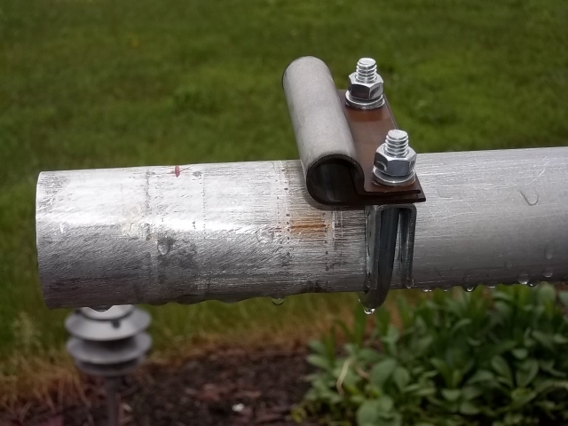

This is the mount for the elem. I will post more with the elements mounted and some of the gamma match.

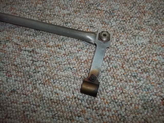

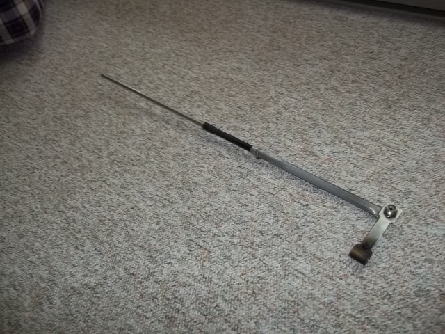

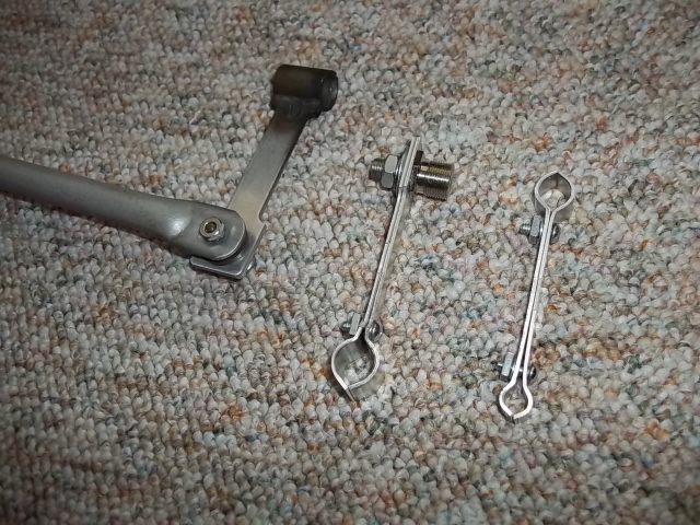

Here is an old gamma from a Maco shooting star and actully all the parts I am using is from this old antenna I got from a SK for the price of getting it and the tower down before the home went up for auction. I called Maco and ordered a new connector which is much heavier than the old original. Also got new straps for mounting the gamma. I did not feel like cleanibg the old ones up lol.
Holy smokes. Literally.
How many kw was he running? jeez.

He ran 3-4 hundred watts, it looks that way because of the nut holding the coax and gamma straps were not stainless and rusted discolaring the aluminum. The shooting star was up mor than 20 years.

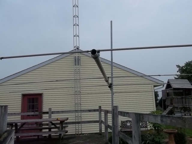

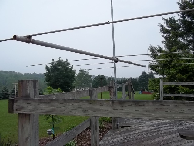

Had one day of no rain for about 4 hours so I rushed getting it together, just need to get the gamma on it and tuned.
more not so good pics here mounted in a short mast connected to my deck railing.

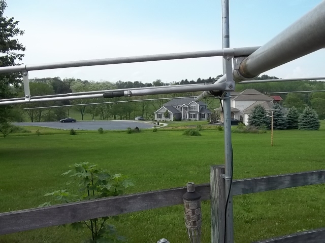

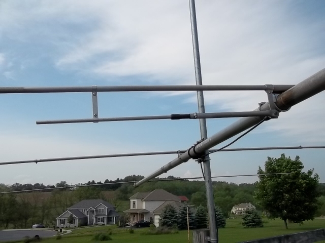

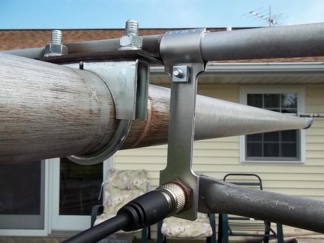

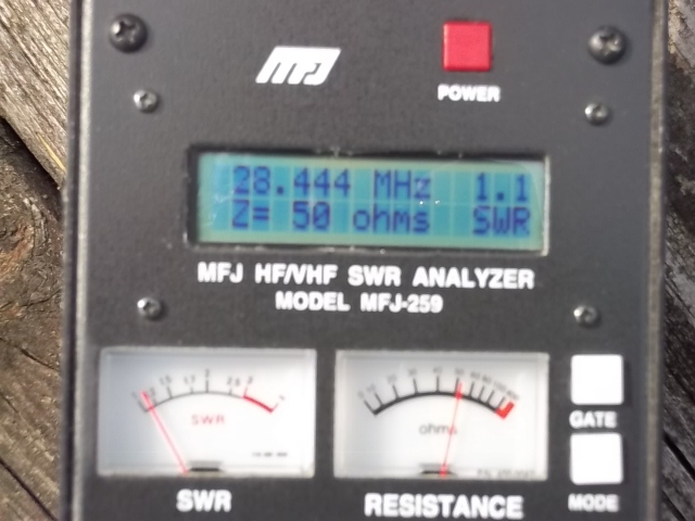

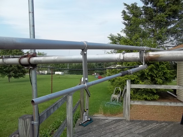

well the weather held for a change and I got the gamma mounted. I was very surprized when I hooked the MFJ 259 up and turned it on, the swr was at 1.6. I tuned the capacitor in about 4" and then the slider strap and got it to 1.1. Here are the pics, I just hope it does not change in the wrong way when I get it up. Oh, it is pretty broad banded too. I can use it without a tunner on 11 also. Must have done some thing right lol.
Check it out.
