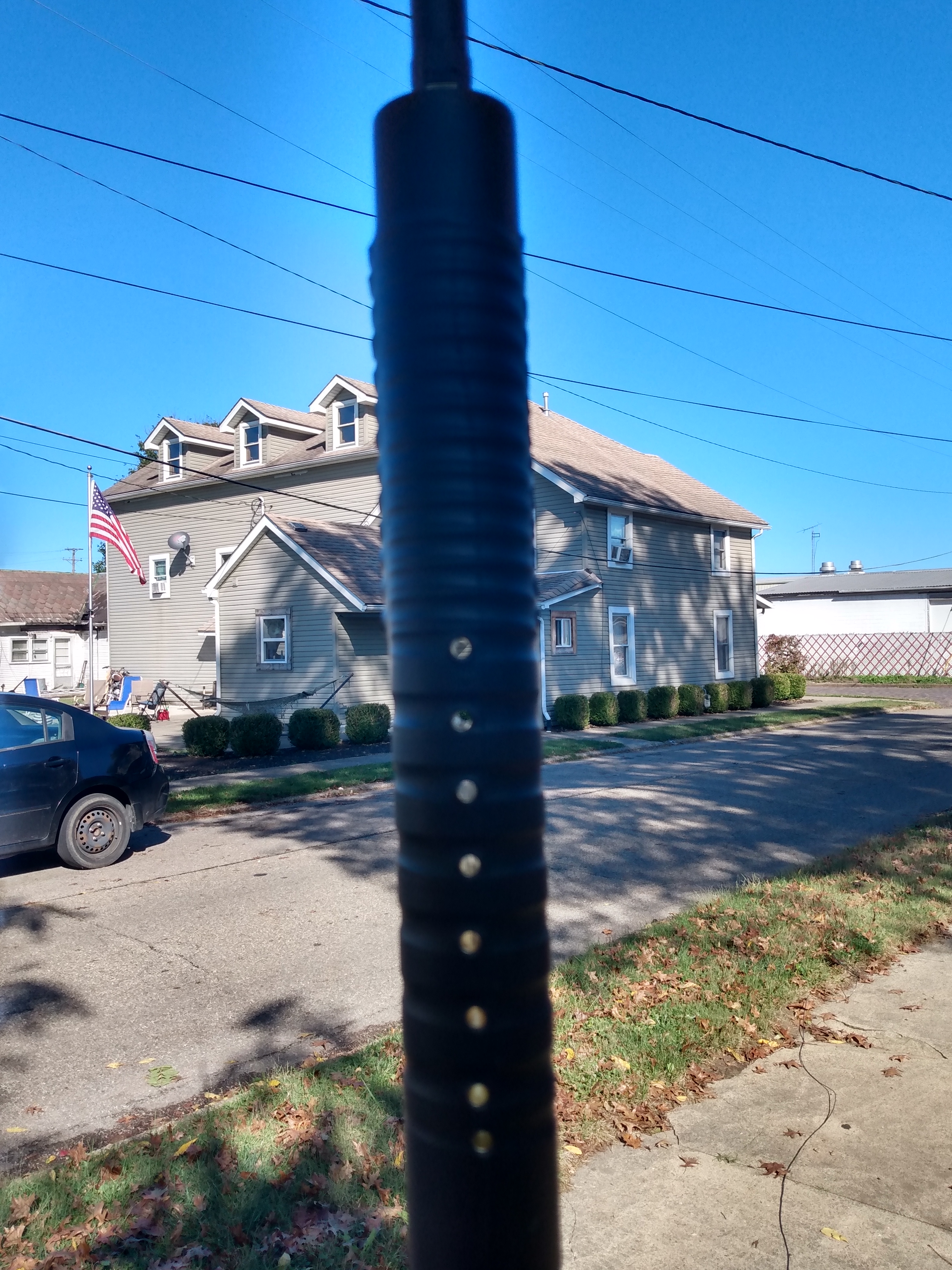

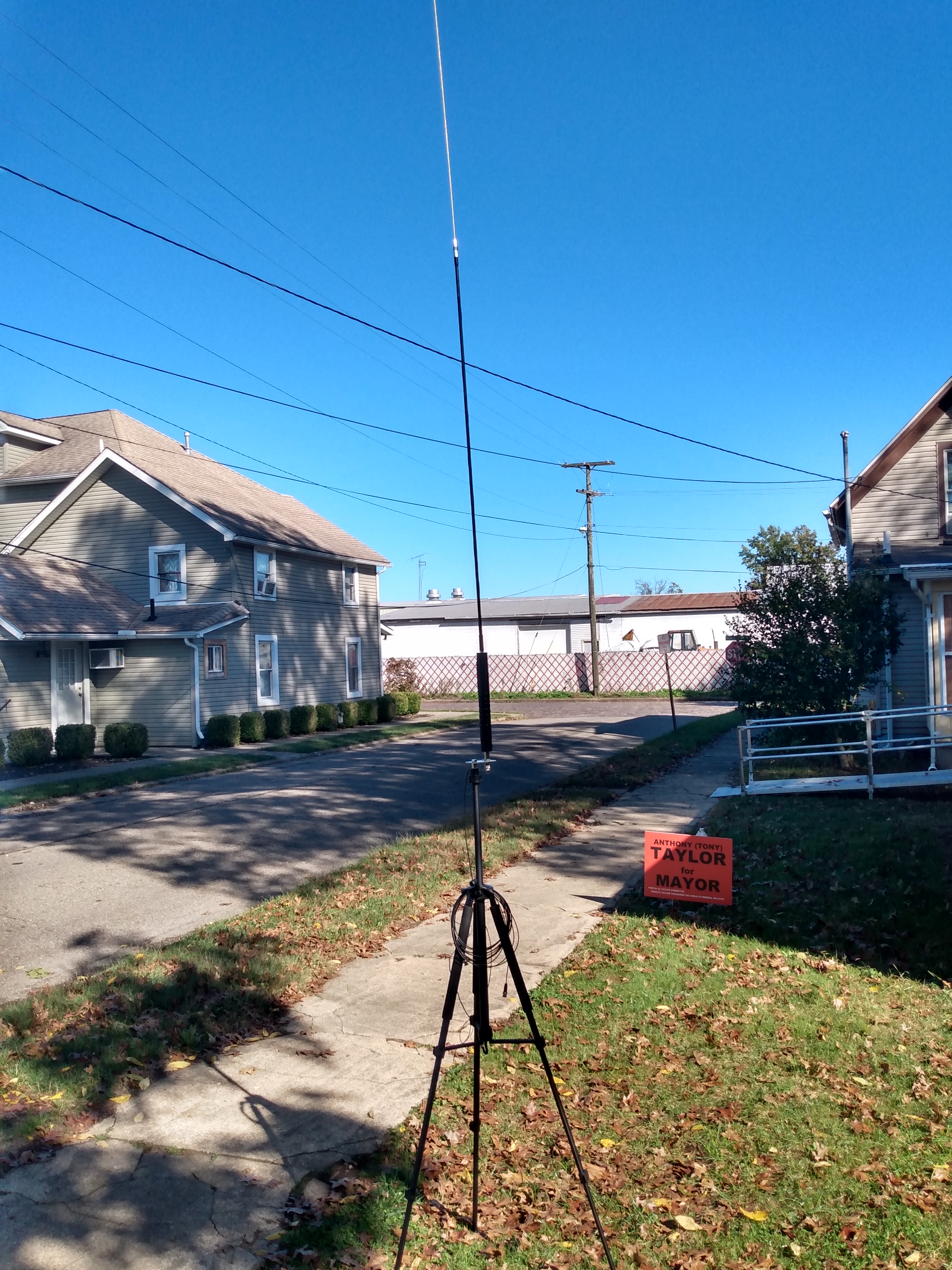

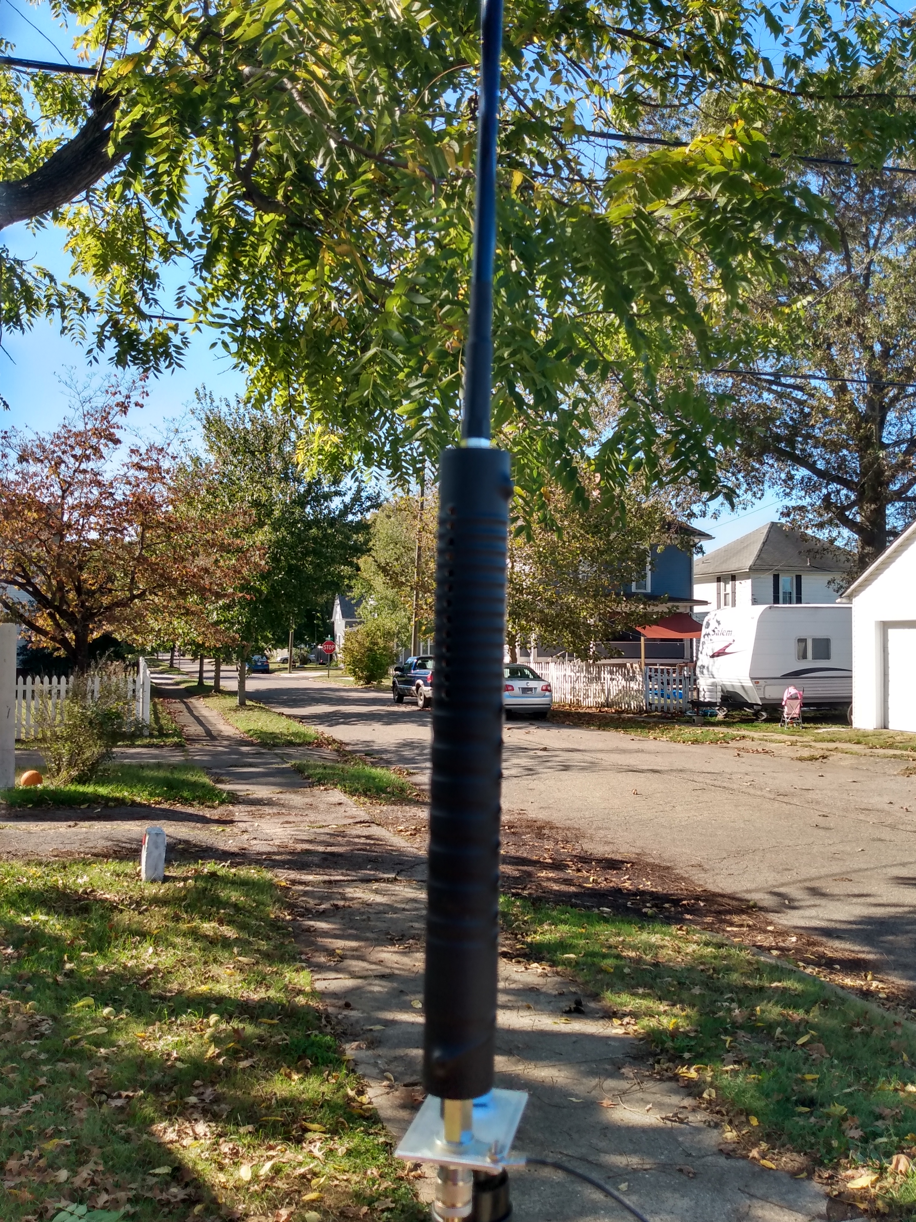

I can't recall the watt rating, but I can screw this down on my screwdriver mount on my Jeep, use it while traveling, then unscrew it and use portable. Since my G90 has a tuner, I don't need to make a choke, although, I likely will in the winter days.

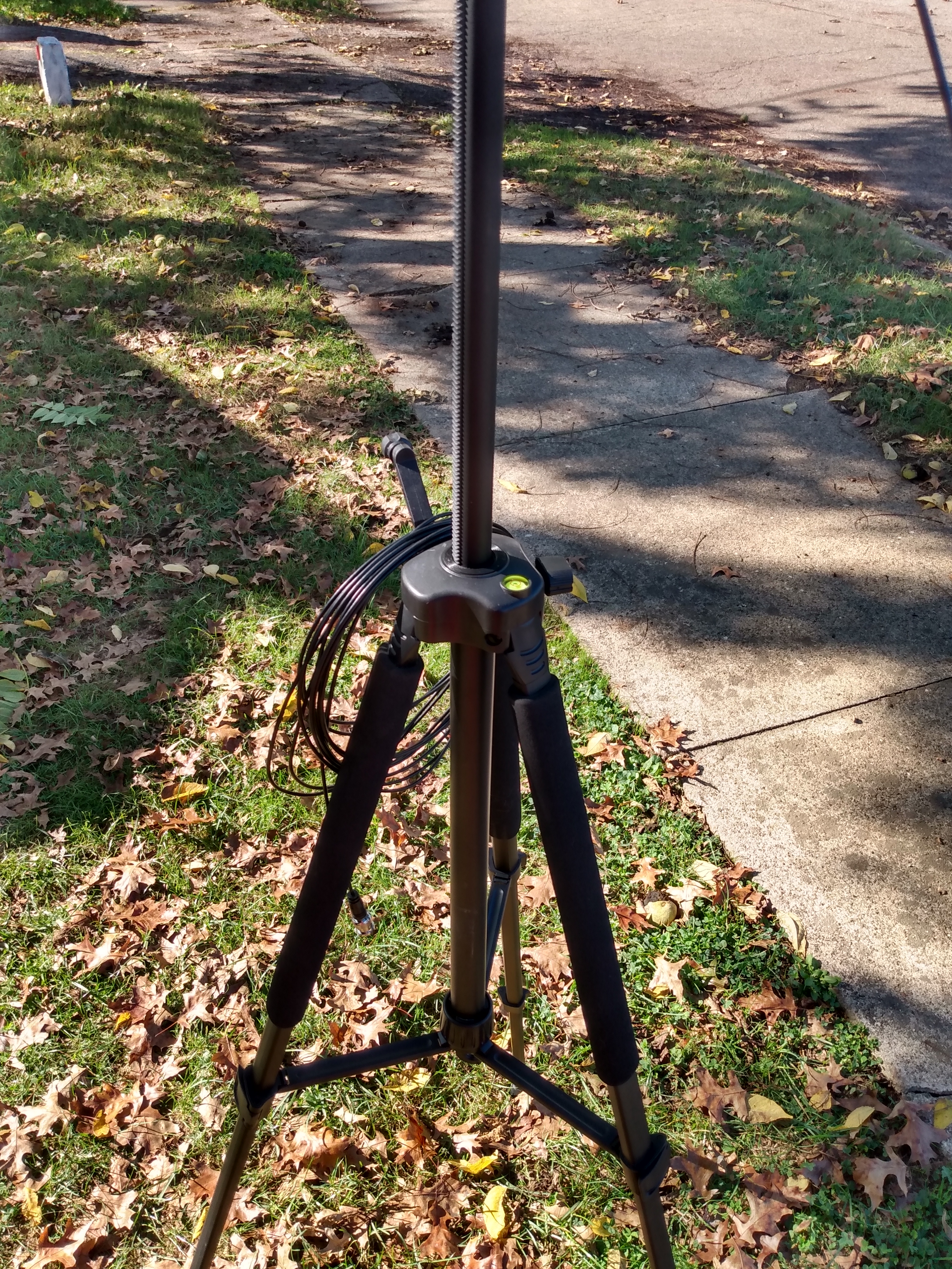

For now, I'm feeding it with a 25' section of RG-174. Same size as the counterpoise and packs neatly.
