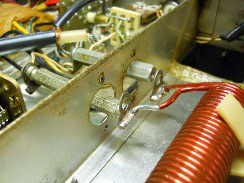

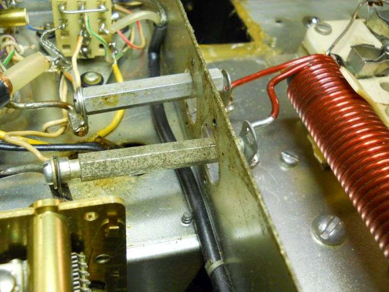

There should be a cylindrical "coaxial" capacitor in the divider's two round holes, bolted to the divider. The two solid-metal pillars I found in place were suspended in the holes pretty well, neither one would touch the grounded rim of the opening, until I removed screws from them.

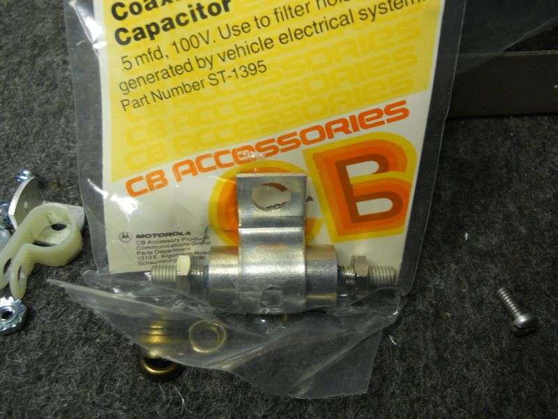

I no longer have a good source for that style capacitor, but I do have susbtitute.
Got a deal on a box of these from a closed CB shop's inventory years ago. Not quite right, but it's the same kind of capacitor.

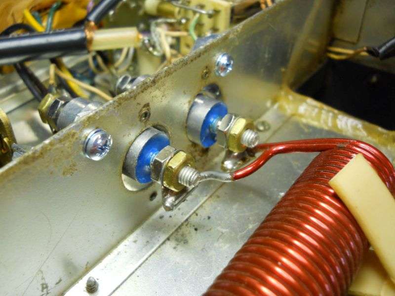

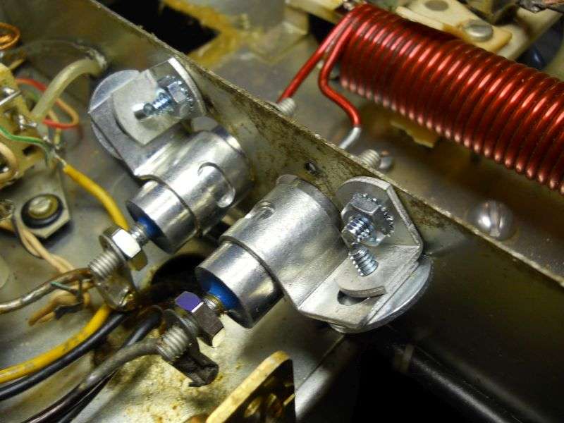

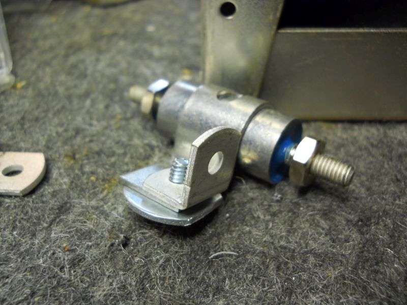

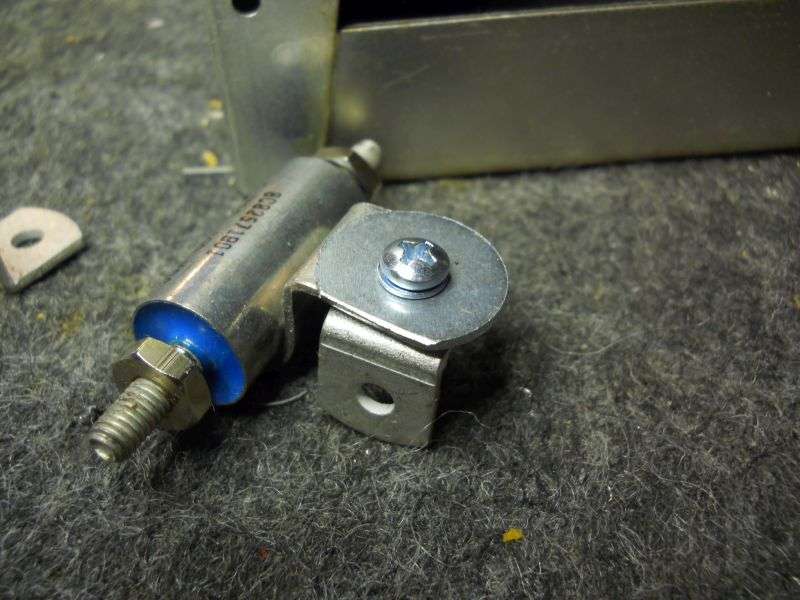

Just gotta get it mounted.
The right-angle bracket is a stock Keystone item from Mouser. We use it for other stuff. Didn't have a half-inch diameter flat washer with a #6 hole, so one edge had to get snipped from the 3/4-inch washer we had.
I'm still trying to decide if it's worth the trouble to plug the open space around the new caps. I suspect the back pressure under the tube sockets in this amplifier is too low to worry about losing air volume that should be reaching the tubes.
