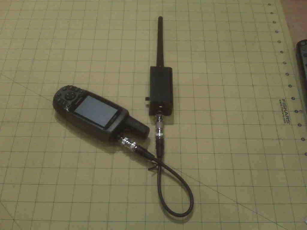

I have a Garmin astro dog tracking system. This gps tracking unit replaces the old radio telemetry systems used for dog or animal tracking. I use this GPS tracking system for hunting with hounds at night. The hound wears a collar with a transmitter. The collar transmitts gps coordinates back the my handheld gps unit. The gps unit then displays the hound's location on a map.
Eough back background info. I am trying to increase the range of this system. Garmin states that the unit has a range of 7 miles, which is highly overstated. In reality, I get about 1.25 miles of distance before I start loosiing signal with the hound. I bought a cheap aftermarket folding telescopic antenna off ebay and it improved range to 1.5 miles.
Is there an amplifier on the market that could work? I know of a guy that has tried this, but I don't know where he got the amp from. On a hunting forum, I found a picture of a modded gps system that had an amp in between the handheld and the antenna. (pic is below)

Get your dogs antenna higher up to see the tower your gps is in contact with or increase the antennas gain.
Hows about he make a mini Yagi antenna and mount it on a broom stick which can be held high over head, the systems now becomes directional.
Really, I would think that higher power collars on the animal would work better than a receiver amplifier; terrain is probably what is affecting your effective range with the receiver.
The transmission has to be repeated to make it back to his receiver so placing his dogs on stilts should remedy the issue.

The issue here is not that your equipment is not operating properly it's an issue that you're trying to use your equipment in an environment it was not designed for, it was designed for line of site including the terrain it's being used in.
The trees, landscape has a lot to do with the equipment operating properly which reduce the overall tx and rx capabilities of the equipment, the same thing happens with common radio transmissions and reception.
Unless you get the txer's and rx'ers up higher and reduce the obstructions between your equipment you probably will not see any improvement even with a receive preamp.
