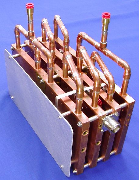

Man, that is a VERY nice 6KW water cooled Dummy load!
Nice!
73,
Jeff
