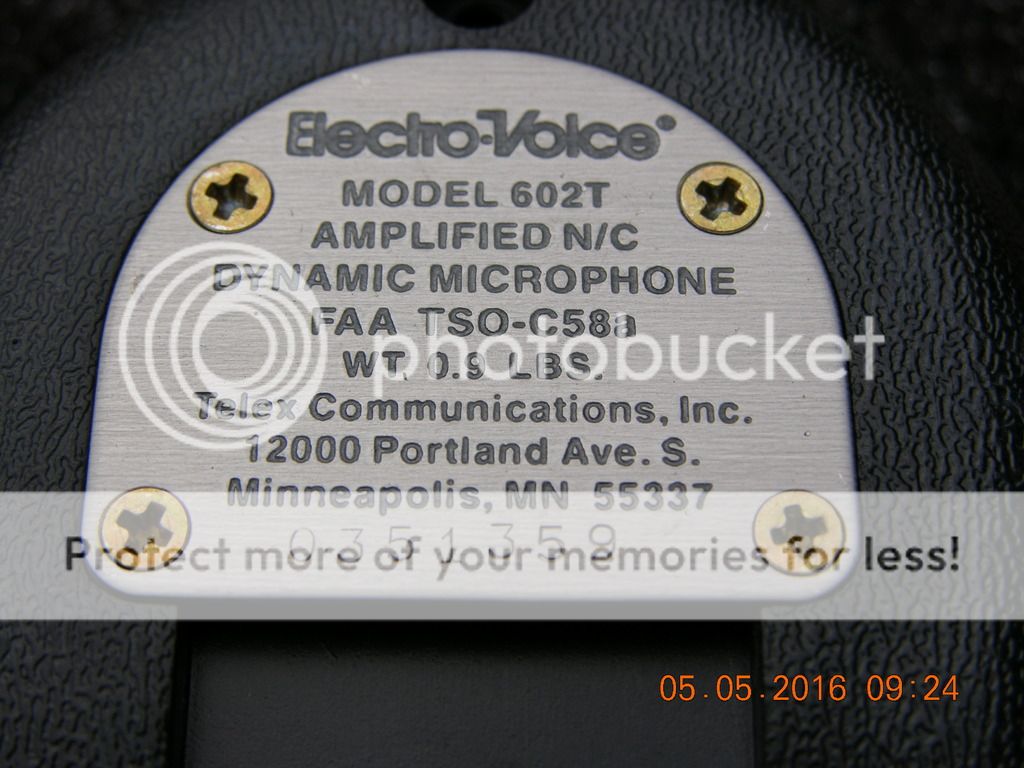

This microphone works great on a Cobra 29.
Reactions: 222DBFL and Bearcat
