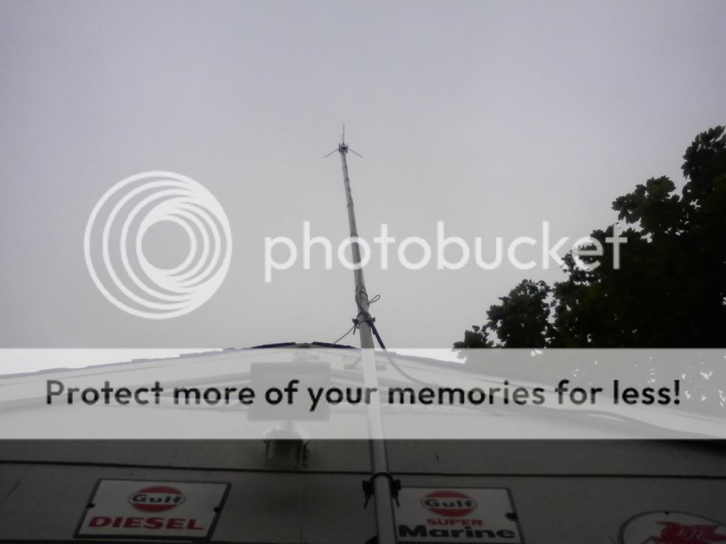

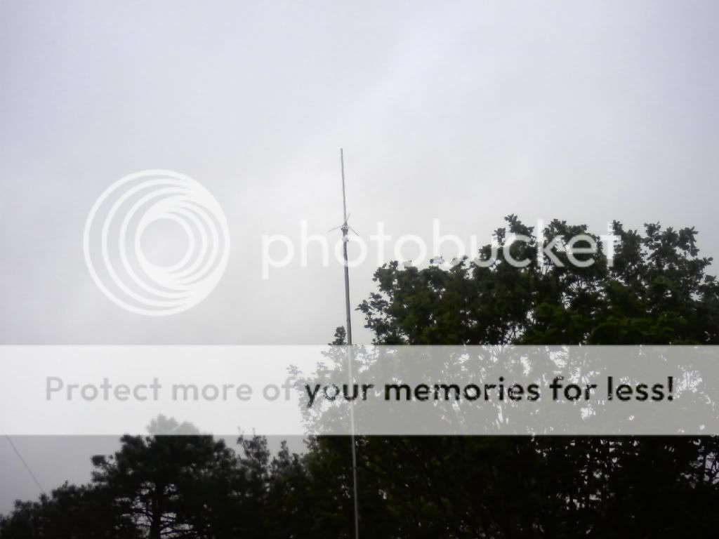

Making a couple of changes to my antenna systems here....
First off I need to improve my VHF/UHF capabilities, all I have at the moment is an R2 Ringo that sits approx 15 feet above ground level, not the best antenna or at a very good height. I was given a couple of Radio Shack standard grade antenna masts that have seen better days. I spent a good part of the day sanding off the rust, two coats of primer, and a top coat of silver hammer finish Rustolium....
Yesterday I placed an order with HRO for a new Diamond X50A which will get mounted to the 20 feet of this newly painted antenna mast, the base of which will be elevated about 9 feet above ground when attached to the wall brackets on the front of my garage. This should put the base of the X50A approx 28 1/2 feet above ground, and that's a little higher than the original X50A I had mounted there 20 years ago, and a lot higher than the Ringo that is there now.
I was also given an old Shakespeare Super Big Stick that I had to clean up, and may need to gloss coat with some clear resin since it has seen a lot of UV damage over it's lifetime.
I'm thinking about mounting this one on the back of the garage, not looking to get it up real high, but high enough to clear the roof line.

The big brown truck dropped off my new Diamond X50A this afternoon, and I had it up in the air an hour later......
Big difference on both the IC-2200H, and the Uniden 440 radio. I found a whole bunch more programmed frequencies on the 440 radio that work since I'm now using a real antenna at a decent height.
On 2 meters I'm getting applicable increases in return signal strength from several distant repeaters, and I'm opening up a couple on the outer fringes that I couldn't hit with the Ringo only sitting about 18 to 20 feet off the ground....
Now I need to get either a two way coax switch, or better yet a duplexer so I can run both radios at once......
