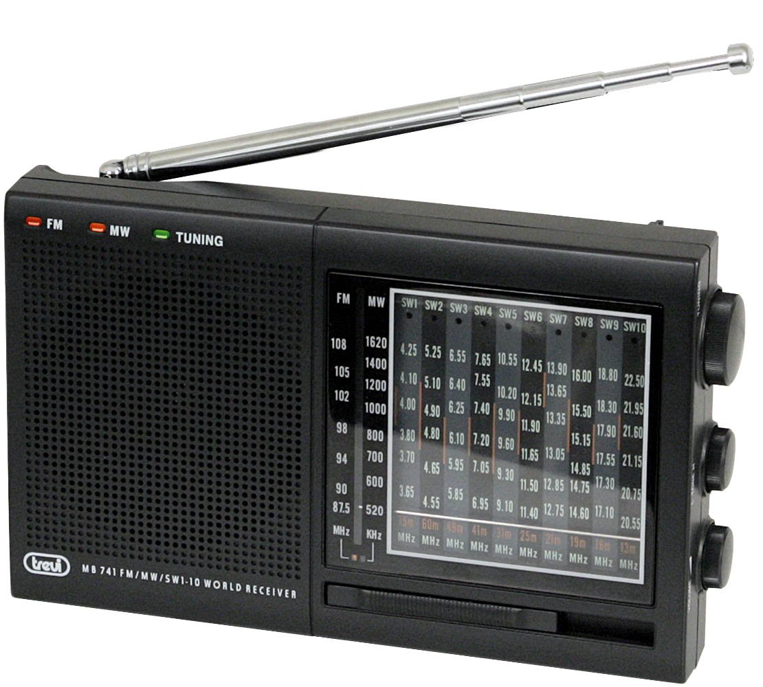

I'm fed up with my Internet Radio, so have treated myself to a cracking little radio from Amazon called a
Trevi 741 Portable World Receiver Radio - 12 Band FM/MW/SW 1-10, as I see it's got some great reviews on there!!
Anyhow what sort of aerial should I need to get the best from this little radio?? An outside one?? What wire should I use and get from where?? Or should I opt for an Internal aerial??

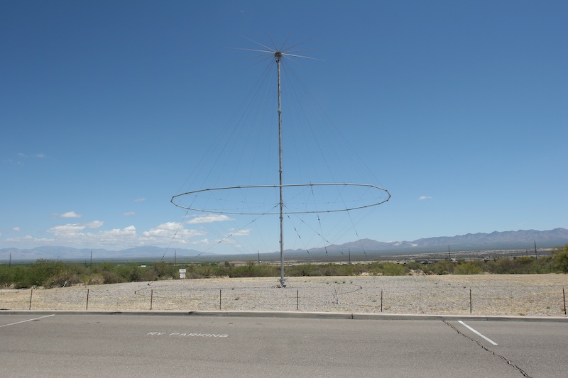

Discone for HF? Stealthy? LOL A discone for HF is far from stealthy. How many acres do you have?
Here is an HF discone antenna.
And for size perspective.

Here's the little beauty I've bought:
Looks to be a good receiver but is limited on HF frequencies as it covers mostly short wave broadcasters and has gaps in band coverage. A favorite of mine is the Tecsun PL-660 and a newer version will be out, the PL-670 soon. These cover the whole of HF, 100 kHz to 30 mHz and have USB and LSB including digital readout and memories.
Expect to pay a bit more for a full coverage receiver with all modes but you will hear many more stations and comms. The PL-660 also has SYNC detection to aid in reception during poor or fading band conditions. Of course a long wire always makes a difference! Think of your antenna as a fish net, the bigger the net the more fish you will catch!
73 mechanic
