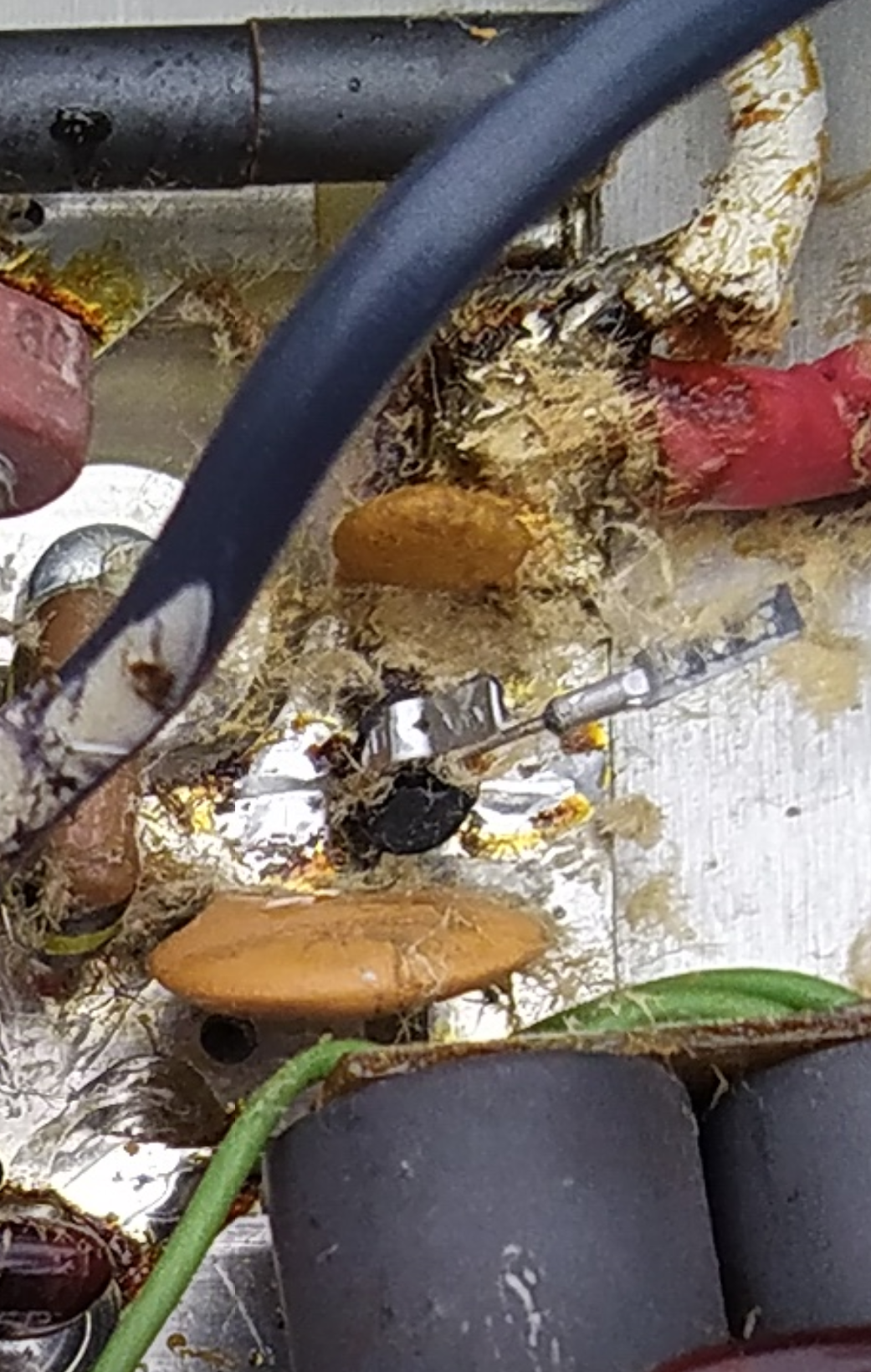

Board as it sits
Here's a closeup of where that cap was. I've left the leads so as to be able to find the location easily.
Alot of stuff looks way over heated. Choke is burnt. Caps are dark.
Agreed. That thing looks like it has been run EXTREEMLY hard. A lot of stuff if well and cooked in there.
I would question the values on all of those brown caps and both chokes are cooked.
Also 2879's have been swapped into this where SRF3222's used to live. I'd be concerned that the caps were the wrong values for the 2879's before they got cooked.
This thing was designed to be used with a very low power radio. Nothing modern short of a very stock 29, and probably that would be too much, would allow this to live very long.
That being said I would have this gone through completely from stem to stern if you want to keep running it. The board will probably need to come out for a thorough inspection. TS amps have a tendency to blow traces on the bottom of the board when they get pushed too hard.

EDIT to add that it looks like there is a burn spot on that red power wire that is really close to a case mounting screw location. if that red power wire was to touch that mounting screw, it would surely blow that cap if it's across the power leads.
also because of the way texas stars are built, there is always a chance of a solder ball rolling under the PC board while you are working and causing a short that you won't find when you pull the PC board up. also component leads on the bottom of the PC board need to be kept very short.
the keying transistor would not cause that cap to blow. if you are having trouble keying the amp, i would look at replacing the relay as they can wear out.

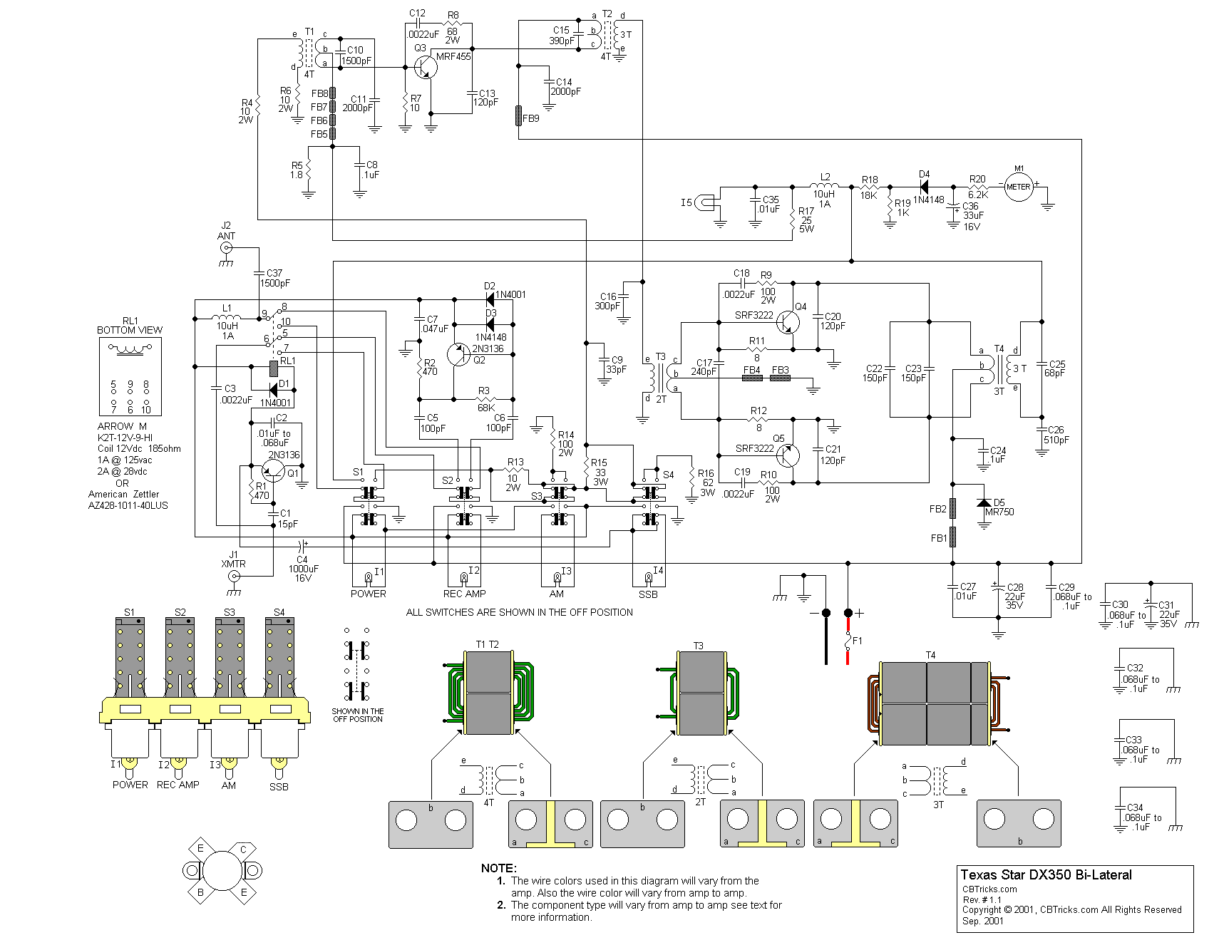

The capacitor that went critical is C28. It serves to filter audio noises from leaking into the amplifier through the power input.
Has no involvement with the relay or keying circuit, as pointed out above.
The capacitance value is not critical. Schemo shows 22 uf. Any capacitance equal or over that is probably fine. Just make sure the voltage rating is 25 or higher.
And how the amplifier will behave without it? Depends on the source of power. A well-filtered DC power supply with short power wires would make C28 unnecessary. Texas Star included it to compensate for long power leads that are too skinny, and properly filter audio noises.
The 5-Watt ceramic bias resistor at the lower-right corner of the pic is dated 1978. The amplifier is probably newer. But not all that much.
