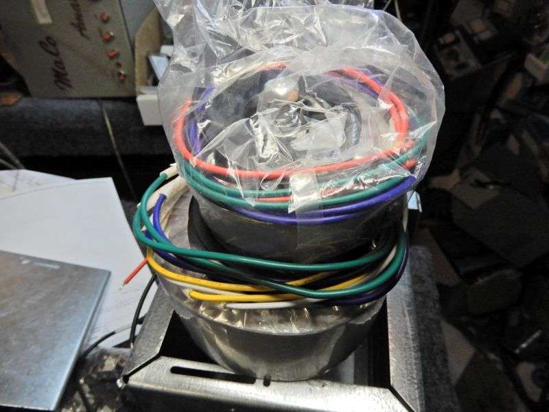

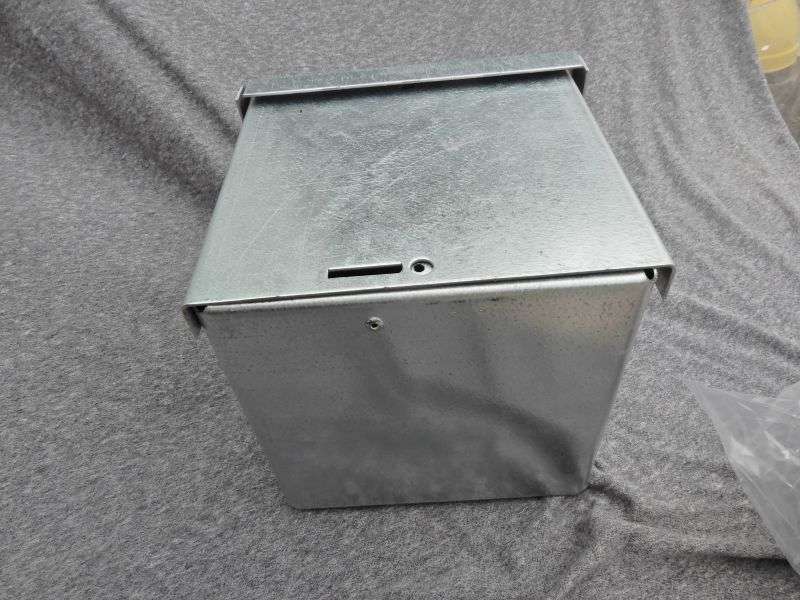

This iron in the fire is finally getting warm. Bought an industrial steel enclosure that cost almost as much as the big transformer.

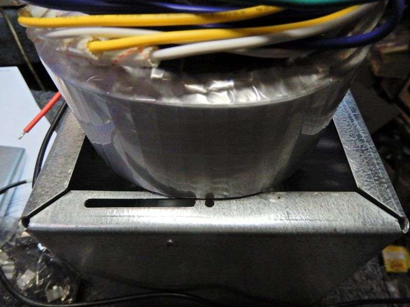

The published dimensions tell you the inside clearance. Big enough for the Antek AS-3T275 transformer. Just one problem the lip around the opening is almost big enough to get the toroid inside the box.
Oops.
Angle grinder time. Gotta find my hearing protector first, though.
The small transformer stacked on it supplies 12 Volts for the heaters in six tubes. The big transformer has two 6-Volt secondaries, but they won't supply the full 6 Amps (or so) needed.

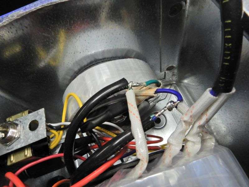

But it has eight wires. Ended up doubling up two pairs of wire for the 12-Volt circuit. The fat two wires are number 16, and the other six or number 18. If I double up two #18s they have more metal in them than a single #16. So I used the fat wires for the 120-Volt primary, two pair of #18 for the 12-Volt secondary and the remaining two #18 for the high voltage.
The P308 Jones plug is a PITA.

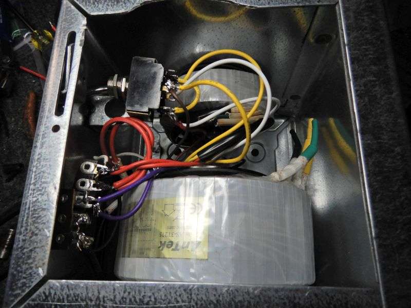

Only had to gouge one edge of the opening to get the big transformer inside. The small one went right in.

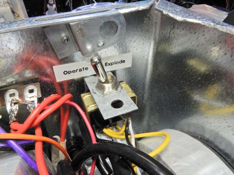

The big toggle switch is the high/low selector for the high-voltage secondaries. The 300A with a full-wave bridge rectifier gets selected with the switch one way. The full-wave doubler version of the RF deck gets half that voltage. The switch simply takes two 275-Volt secondaries and puts them in parallel or series.
Figured I would label the switch "Operate" on the low-voltage side and "Explode" on the high-voltage side. Even if I hide the switch inside, you gotta know someone will flip that switch just to see if he gets Mo Watts.
And if he calls to complain that his RF deck exploded inside, I'll just point out the truth in labeling part of what he ignored.

I did make good on my threat to label the high/low HV winding selector switch. This amplifier has a full-wave doubler HV circuit, so it needs the lower 270-Volt setting.

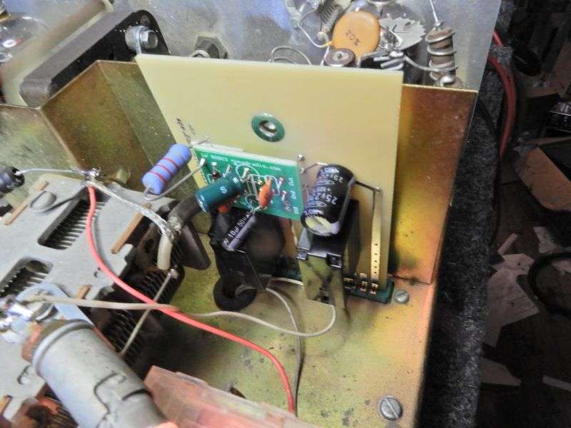

Big attraction being able to power this amplifier up, I finally get to try my substitute relay circuit board.
And it works, thank goodness. I have two more of this prototype board. It needs a couple of refinements before it becomes a product.
