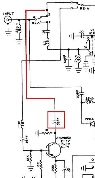

Hello everyone, I'm restoring a 1974 Palomar 200-X linear amplifier. I have the original schematic, and am in the process of replacing out of spec components.

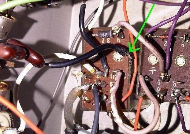

I need help to figure out where 1 of the components connects to - a 33pf capacitor that goes to one of the relays. I think my relays have been replaced, so the corresponding numbers on the schematic are useless.
Would anyone happen to have one that they could provide a photo of where this components connects to? One side of it is still connected to the 2N2905A transistor.
Any help would be greatly appreciated.
