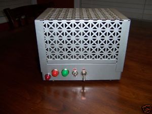

Bad link. Take a photo of the amp and post it. Most probably it is a Mini Scout or regular Scout....how many tubes and what kind will answer the question. If the light you are referring to is behind a screw on lens it will show output. A #47 bulb is what it uses in both cases.
i seen that one on ebay. didnt it have 3 lights.? i think the one i got only has 2 lights. 1 red light and one small green light. i think the red one on mine lights up when you modulate. the green lights up when you power it up. its been a while since i used it. if you want to buy another one mines for sale and its in mint brand new shape.
Yeah, someone added it. My guess is that they wanted a "standby/on" light as well. The amp is in the mail so I will see what's up in a couple of days.
Edit: It has a single 6CA7/EL34 tube.

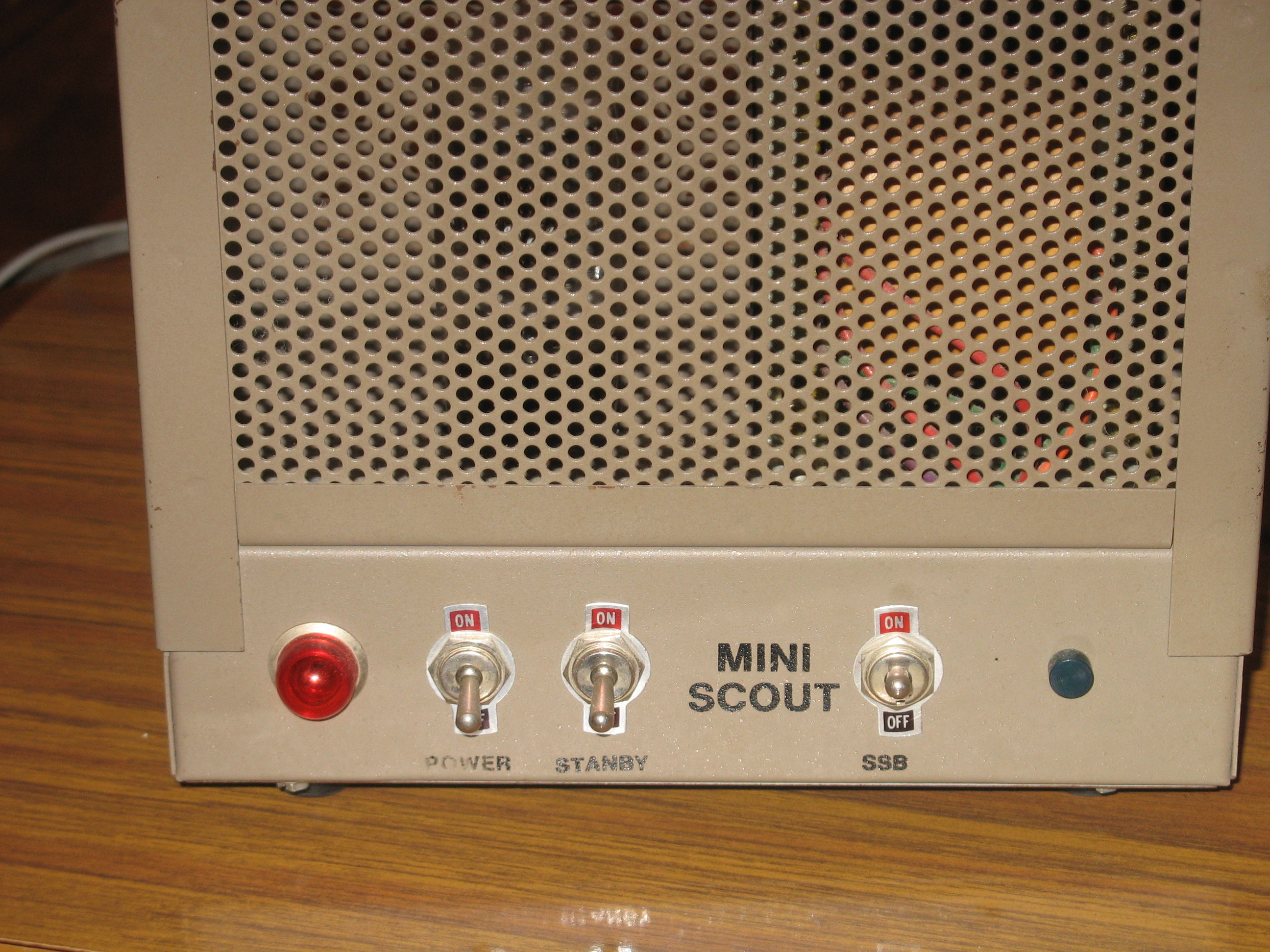

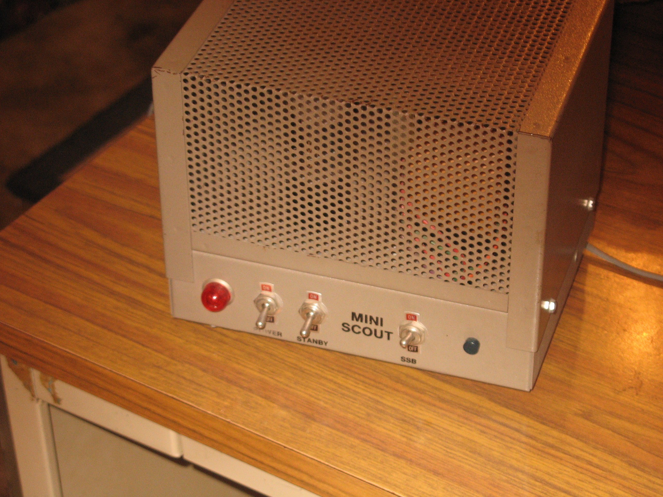

mine is brown. 3 toggle switches. on / off, standby; and a ssb switch. tried to load a pic but was to big. yours looks like the color and type of style my scout 20, 8 tuber looks like.

Mine has two different length switches. The one on the right (standby) is longer. I bet the short one for power is the stock one...right? I wonder if that added light is hooked to that standby switch. It would be nice to have a light for the standby so I don't accidently run all that power through my sweep tube amp.
The left switch should be for power, the right for Standby. Red lamp for power, green lamp for power output. The 6CA7 is an acceptable replacement for the original 8417 tube with a few changes. Yours will be an earlier version of the tan ones.
What I was asking is did it come with the long or short style toggle? I'm sure it didn't come with 2 different length switches...right? I would like to have both switches be of the same type just for cosmetics. I probably will just use a rubber plug where that added light is just to get it back to looking like a stocker.

You are correct. When new both toggle switches would have been the same. They should have been short metal toggles. Depending on what type of wattmeter you use peak wattage should be between 75 to 90 watts. Set the dead key from 6 to 15 watts max. If you use this amp to drive a larger amp you will need to drop the dead key to 2 watts or so. Using it for a driver will also shorten the lives of the tubes in the larger amp. That is unless you are driving an amp with 572B's or a single 3-500Z.
