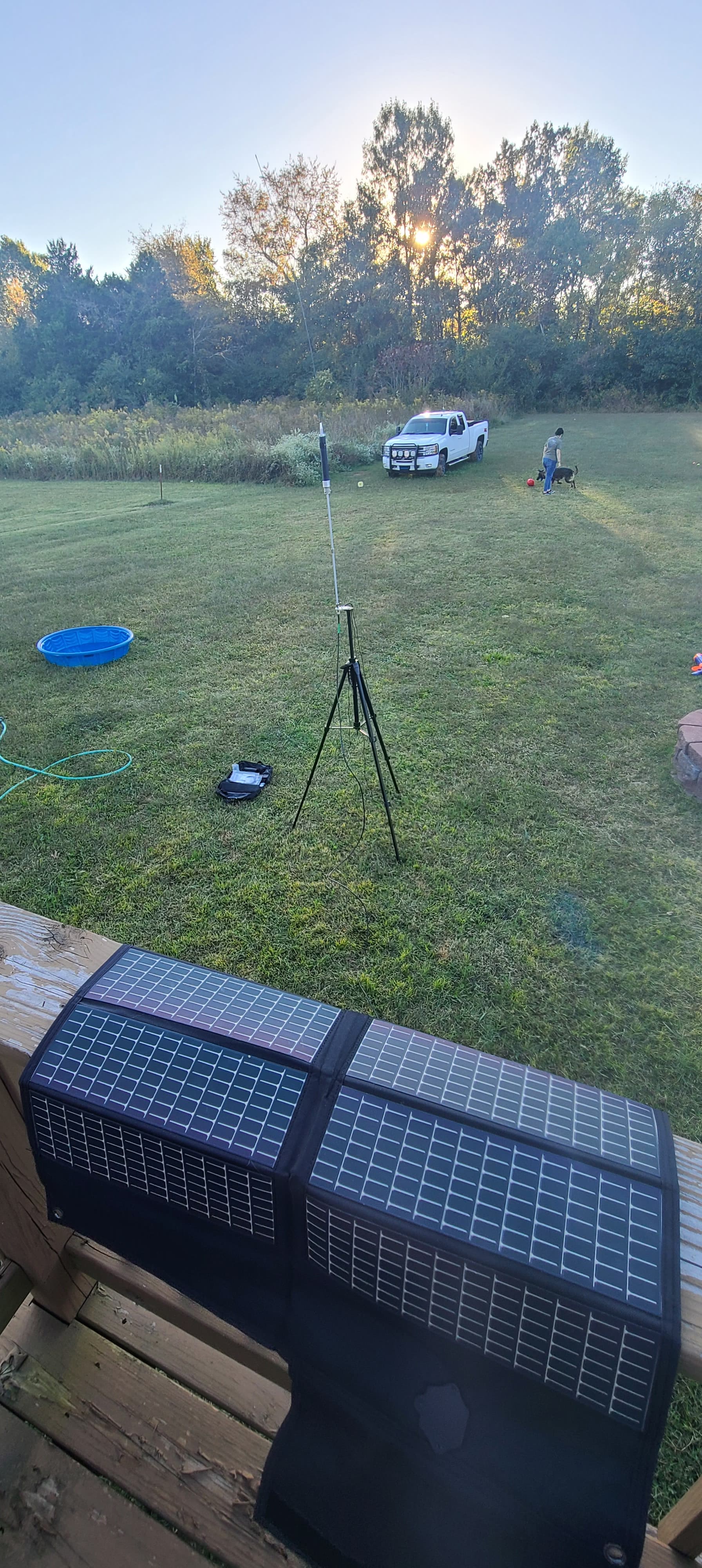

Was going through storage yesterday and found my super antenna that is a tripod mount. Completely forgot that I had it as a spare after moving. Got to get a set of radials for it and I'll get it out and play with it.

It’s likely on par with both the Buddiestik and Wolf River antennas. Be sure and report back.

I am really liking this antenna. Super simple to set up, and packs down very small. I am having better luck out of it than my base vertical that is 34 feet to the tip! Hardly any noise level exists when using this antenna!
