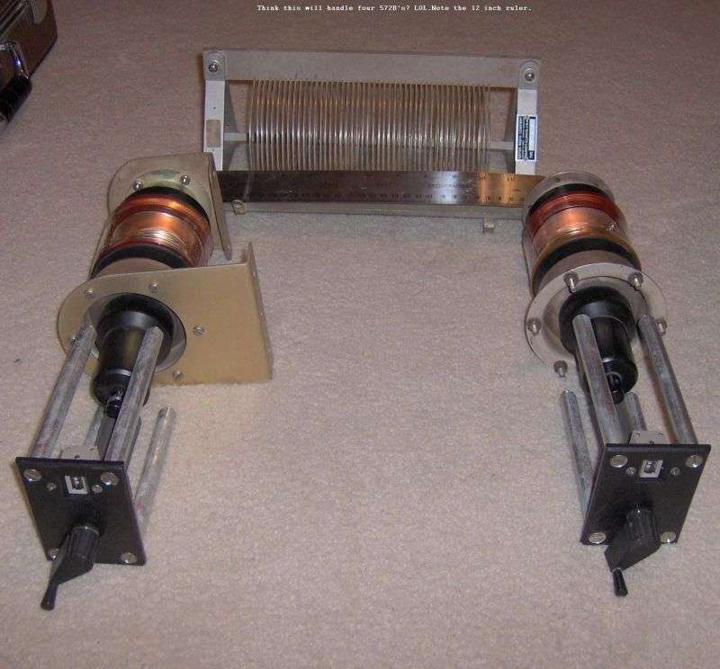

My favourite tuner is the one I haven't built yet. A pair of Jennings vacuum varibles of 1000 pF each and a huge silver plated edge wound 3/8 inch ribbon inductor. :drool: I can't decide to build it right into my RCA BTA-1S converted broadcast transmitter or in a separate outboard cabinet.Here are the components I have to use along with some heavy ceramic switches not pictured.
Boy QRN, you sure have access to some neat stuff. Any time you feel like building something just for the heck of it and decide you don't want it, let me know. I sure I can find a use for it :)
That's OK mole. I am a "greenie" and like to recycle things including RF projects. I'm also greedy. :love: That coil came from an antenna tuning unit at an old AM site and the caps are from a Continental 10 Kw AM transmitter that was scrapped.The roller inductors came from an old Harris 20 Kw FM transmitter that was also scrapped. I'm thinking I will built it into a separate cabinet and that way I can use it either as a regular tuner or cart it off to the basement and use it as the final Pi network in the RCA tx.
