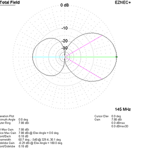

EZNEC modeling of the 2m Gizmo

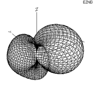

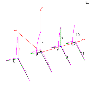

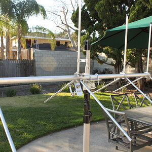

Assembly finished
Assembly finished

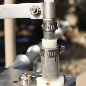

Close-up of Gamma match assembly
