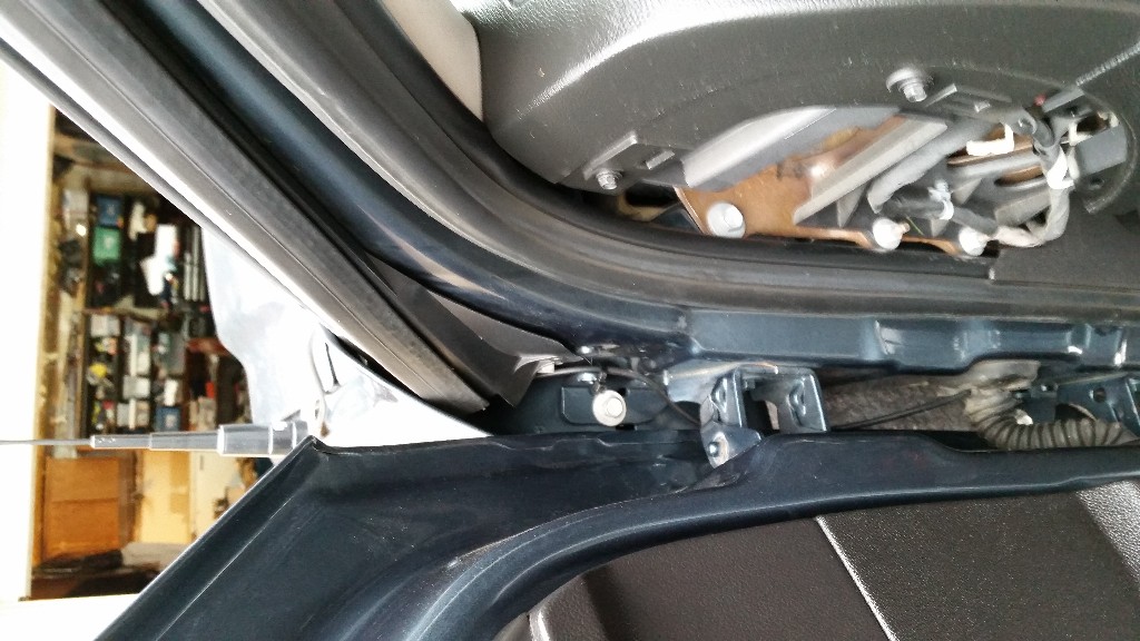

This is a fender mount. The coax comes down through the fender and through the door. There is already a boot there...just a single hole through the boot and silicone. The wire comes through by the fuse box inside the cab.
