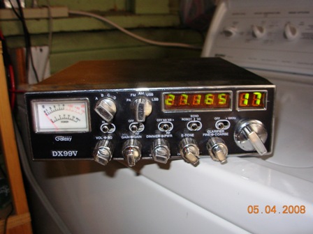

99v Is a oldie but goody. I inherited one from my late uncle. Had bad frequency loss and drifting issues. Turned out to be two problems. Bad solder joint on the 10.240 crystal and the channel selector needed to be cleaned. Works great.
