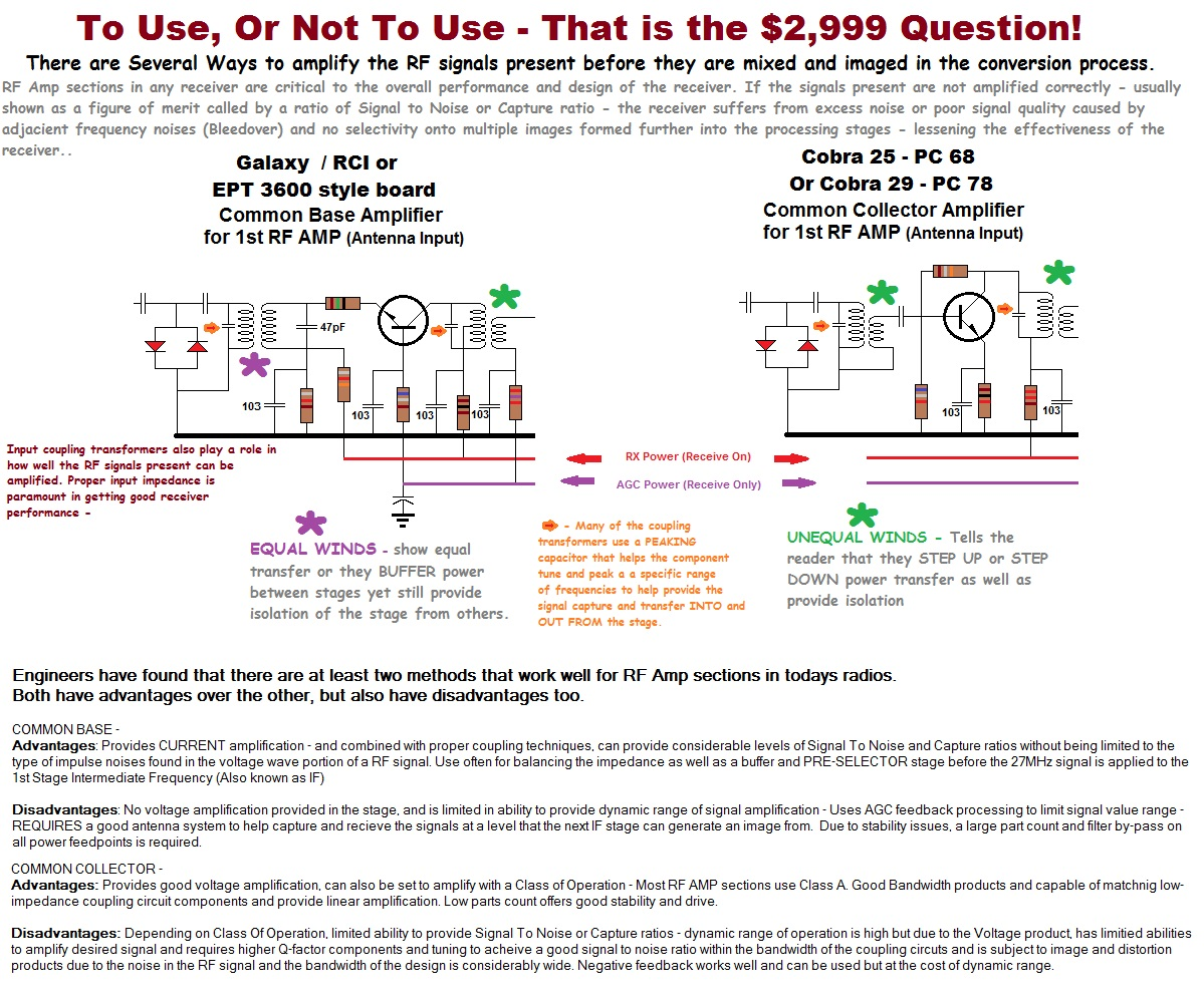

A review of differences between Common Base versus Common Collector amplifier in RF receivers...
The C25/C29 RF Preamp should be listed as Common Emitter, bypass cap (103) on the Emitter.
How to perform the 2sc2999 and Schottky diode swap
