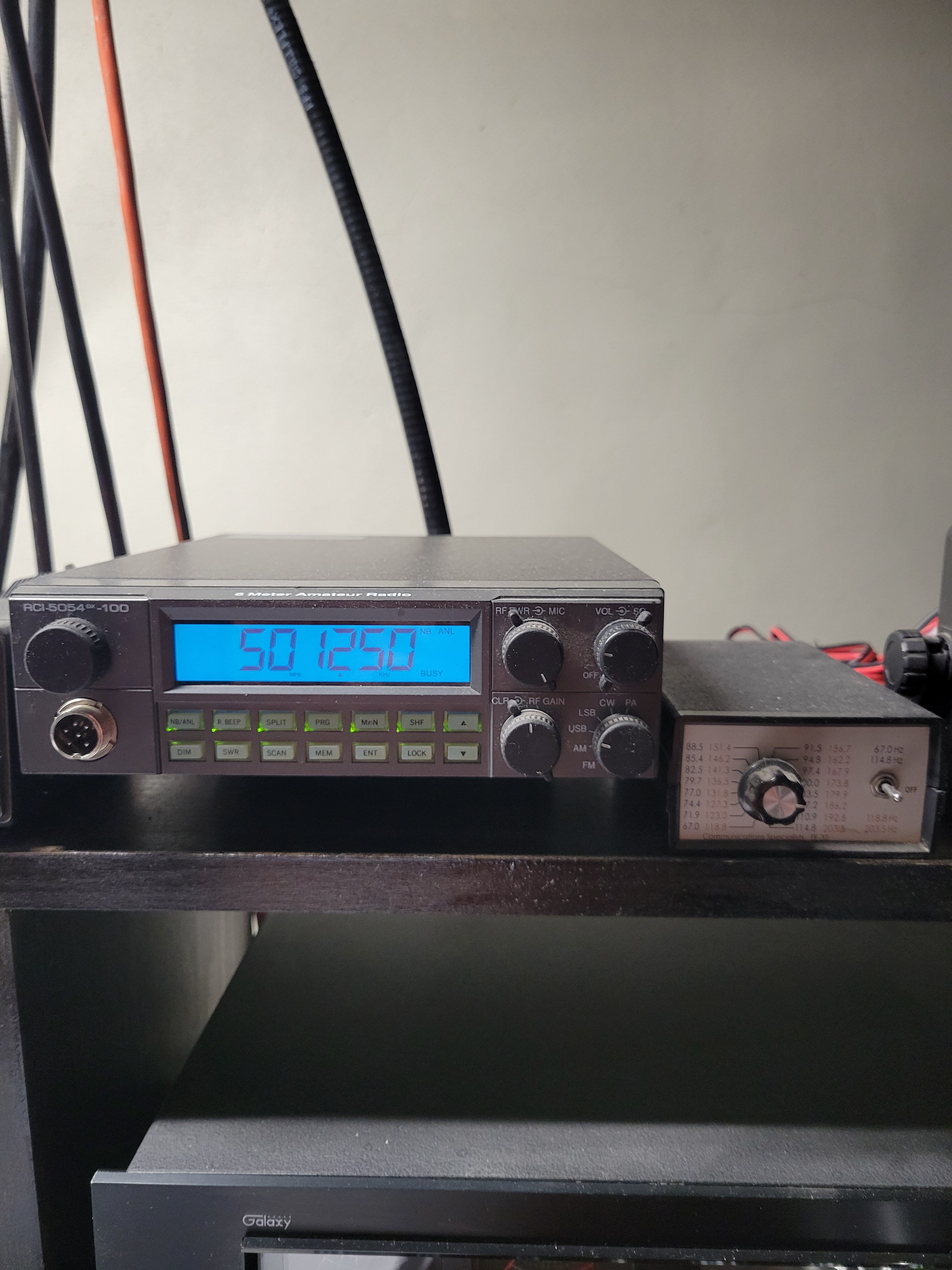

I picked up a RCI 5054 DX a few years back on a trade. It came with a Communication Specialist TE-32. The previous owner already wired it in. I believe it's only 3 connections. All info was quickly found on Google. They can be found relatively cheap nowadays...

I had the Com-Spec CTCSS board put in by Chip over at RCI when they were in San Diego. While it did work, it wasn't very convenient because you had to open the radio covers to change PL-tone frequencies via the DIP switches. I eventually sold that radio.
The CTCSS box that Blackcat on the above post is a better way to go for easier PL tone switching but unless you make some kind of disconnect, it isn't very practical if you move the radio around a bit.
