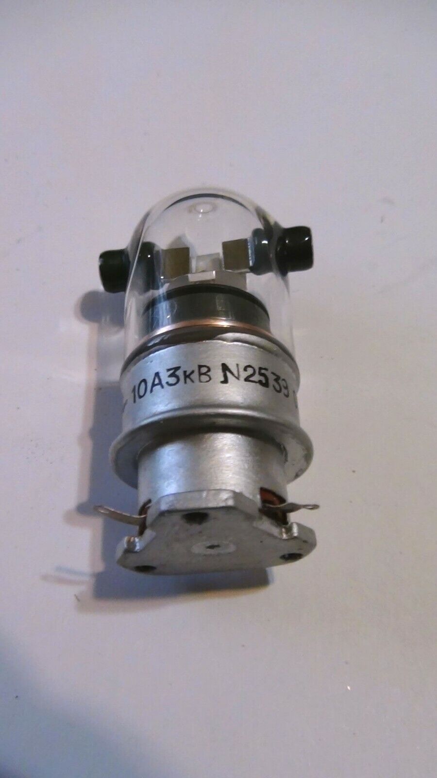

I could not find and/or decipher the coil current requirement for this common 24v, Soviet relay. (datasheet in Russian). It's sold by several online vendors for as little as $30 plus shipping (>$10). The relay base is common to several configurations (SPST SPDT, etc). I found that the relay will not budge with less than 92-95mA at 22vdc.

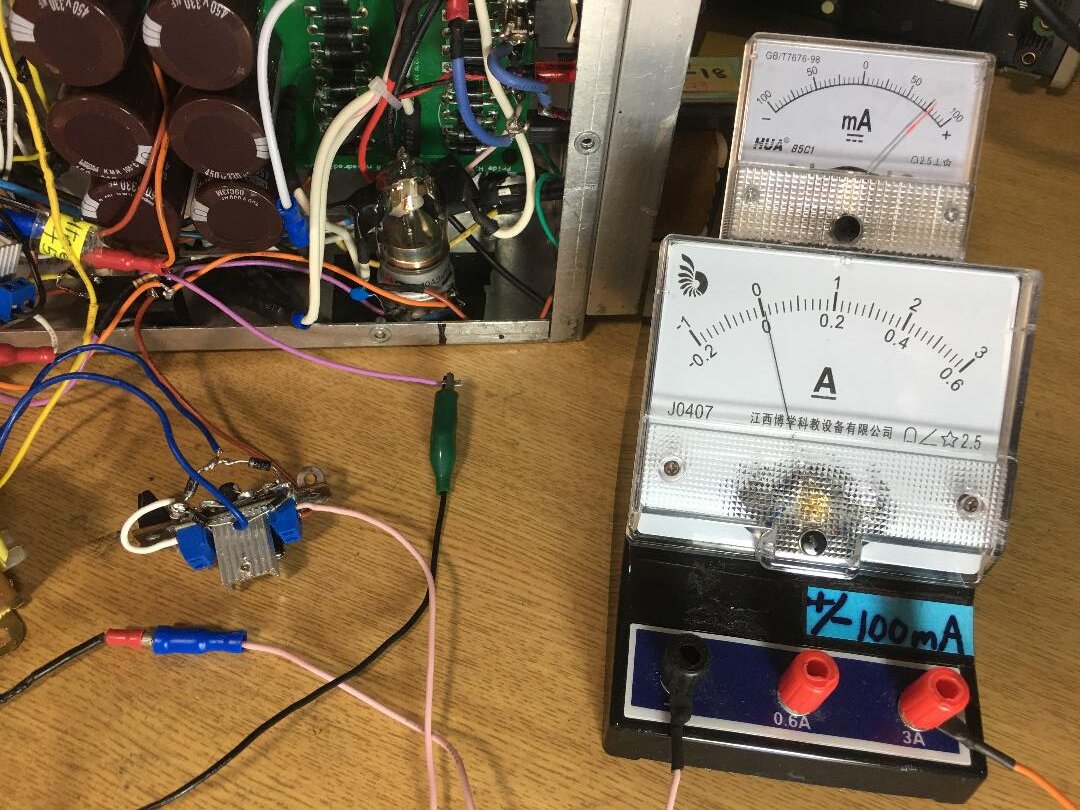

I isolated the relay with it's own PSU and keeping the relay closed requires 75mA.
PSU is scratch from a separate 24v transformer* feeding a small FWB and then a LM317 regulator module set for 22vdc**. Module heatsink gets almost hot. Placed near a fan now so it's workable.
* ** Amazon product ASIN B0B6WL4LGV
EDIT: See pic
