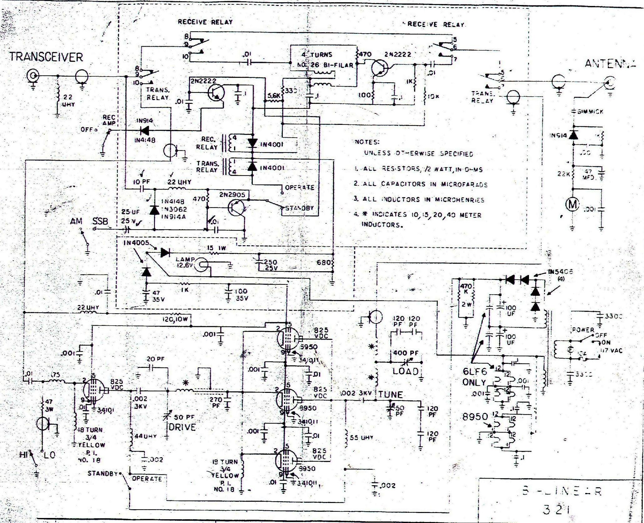

Also on low watt setting is this cutting the driver tube and going straight to the final tubes?
No, the Lo-Hi switch is not bypassing any stages or, changing the amount of plate volts on the tube, that switch is adding bias via a 47 ohm resistor to the driver stage.

Hello Paws 263 appreciate the info there. I was able to obtain the schematics through your HyperLink. Sincerely appreciate that. Will set the drive up to 4 watts and keep the audio about 95% on the scopes. You sure know your stuff there. And Tonyv225 Thank you for your input will keep thing smooth as to not kill her. Sincerely appreciate all the Info . Amp should be here tomorrow. Will keep you posted on its working conditions. Best regards and wishes to all that participate and who read my Thread.................LightFoot with the Golden Wave........:wink:

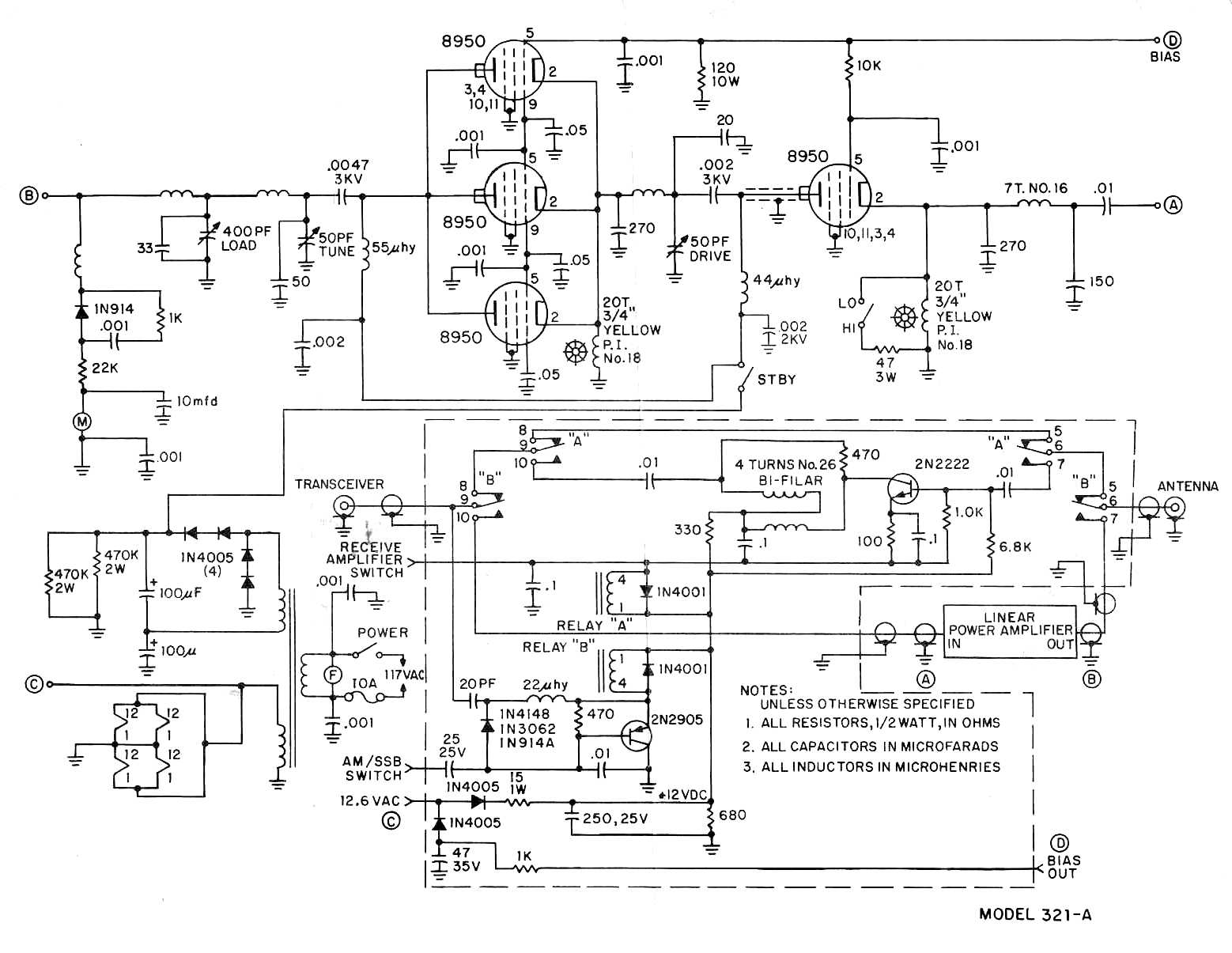

Don't know if you had these or not, but here they are. The 321 and the 321A
