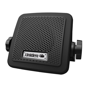

This is what I use in my mobile:
Uniden Bearcat BC7 Compact CB Speaker

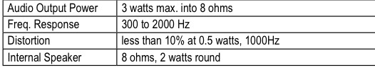

Example manual: http://www.ftldist.com/media/manuals/PRO505XL.pdf
Been looking at tech specs of radios and audio gear for going on 40 years now. You are preaching to the choir now. LOL :biggrin: Interesting how in that link it states the audio power out is 3 watts into 8 ohms and then states that the internal 8 ohm speaker is rated at 2 watts. LOL

CK,I rarely have to turn up my 505's volume up over 1/3 of the way with it hooked up to my Uniden BC7 ext speaker. Anything more is just too loud and distorts. Here's the 505's manual pic
Yes that's exactly what I meant. 3 watts of audio available and a 2 watt speaker to handle it. Most external speakers are rated for 5-10 watts anyway.
I always pay attention to the distortion numbers. The 505's distortion figure is less than 10% at .5 watts @1000 hz. I wonder what the distortion figures are at other sound frequencies They might as well say 9.99%. Clean sound reproduction is usually not at max volume levels.

10% THD is about the limit anyone wants to listen too hence that is pretty much a standard spec. They also use 1000 Hz as that is a standard reference frequency where most level and distortion tests are done. It is also a frequency where the human ear tends to be most sensitive. Also clean sound reproduction is almost NEVER at max volume levels. As an amp runs out of headroom distortion products increase however some amplifiers are designed such that they will produce maximum rated output while maintaining enough headroom such that the distortion at full output is no more than at 1/100th of rated output. Most radios and low end audio gear use 10% THD as a benchmark while higher end gear uses somewhat less. My Yamaha MX-830 stereo amp is speced at a true 170 watts per channel into 8 ohms at 0.003% THD. with 2 dB additional headroom. That is not much more than what it produces at only 1 watt output. :D
